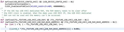

Hello, from this example frdmkl27z_dev_cdc_vcom_bm, after stepping over the code. I have some problems running the code
((uint8_t *)FSL_FEATURE_USB_KHCI_USB_RAM_BASE_ADDRESS)[i] = 0x00U;
in this part is going hardfault file code is not working.
Here they talk about USB RAM/buffer, but we are not using extra RAM/buffer for the USB.
How do I need to change this part?

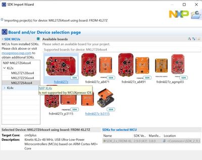

I am using MKL 27Z128LH4 MCU custom board, following SDK
My professor said maybe I am using the wrong SDK or wrong board example, but the same SDK I2C is working on my board.
Please do my SDK and USB example is accurate for the MKL27Z128LH4 board.

The KL27 does not have dedicated USB RAM.
The Buffer Description Table (BDT) needs assigned to local RAM, as shown below.

#define BDT_PER_EP (4U) /* 4 = (TX Odd/Even) + (RX Odd/Even) */
* Every endpoint direction requires two 8-byte Buffer Descriptor (BD)
* entries. This part is Little Endian.
typedef struct BDT
uint8_t bdctl_u8; /* Buffer Descriptor Control BD[ 0: 7] */
uint8_t rsvd_u8; /* Reserved: BD[ 8:15] */
uint16_t byte_count_u16; /* Byte Count. Only ten bits are used for the count. BD[16:32] */
uint8_t *addr_ptr_u8; /* Address */
} BDT;
* There are:
* * 16 bidirectional end points -> 16 Rx, 16 Tx end points,
* * and there are ODD and EVEN buffer, for ping/ponging, -> 64 bdt's.
static BDT bdt[( ENDPOINTS_USED * BDT_PER_EP ) ] __attribute__( ( __aligned__( 512U ) ) );

Some KL27 models are with dedicated USB RAM, some KL27 are without dedicated USB RAM. Don't remember if this information can be found inside device datasheet. But it should be in MCUXpresso device (exp board) memory tab.
I used custom board  with KL27Z64 that have dedicated USB RAM, and CDC example for related exp board was working fine.
