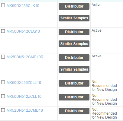

Hui_Ma
Customer could check Product part number to get the silicon version (the part number with char 'Z' means silicon Rev 1.x), just using below picture as an example:
The [MK50DX256CLK10] is silicon Rev 2.x product;
The [MK50DX256ZCLL10] is silicon Rev 1.x product.
Your used MK50DX256CLK10 product is silicon Rev 2.x product.
Wish it helps.
Ma Hui
