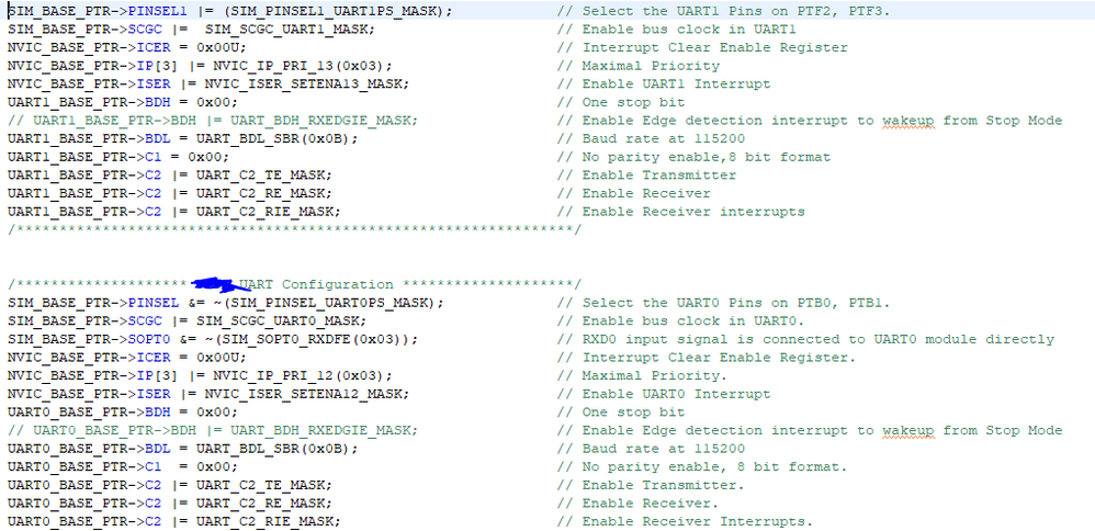

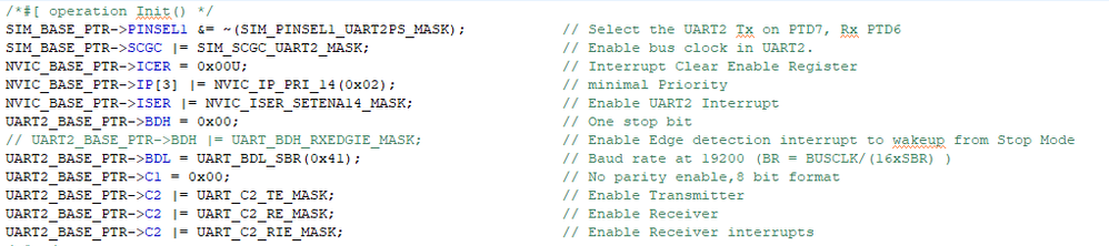

Hello I have to use the 3 uarts that I have available, using UART0 and UART1 are working fine once I add UART2 i cannot run my application ( but I can debug it without any problem ).
UART2 initialization
UART0 and UART1
The only difference is the baudrate, but everything else is the same, but when I call UART2 I cannot run my application only if I am in debug mode.
I have seen something weird each time I change the priority back and forward I can run the application 1 time but after the first time it stops working again

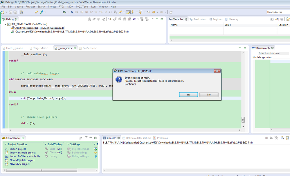

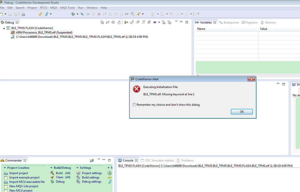

tonymor90
TargetMain_Main is my main, that project should run if you click yes, because that's my main.
I cannot simplify the project it has a lot of callbacks to different files to make it work, I will send you the path to the UART configuration and LED.
If i simply the code it wont be possible to compile it
TargetMain.c Function
BLE_TPMS\BLE_TPMS\Sources\PlatformPackage\ActualPackage
UAR.c
BLE_TPMS\BLE_TPMS\Sources\PlatformPackage\ActualPackage\HalPackage
GPIO.c is for LED
Lin.c has the configuariton for UART2, the one that does not work
3,688 Views
kerryzhou
Hi Hugo Moran,
   This is the click the yes result:
I will create a new project which use the 3 uart, then send it to you.
