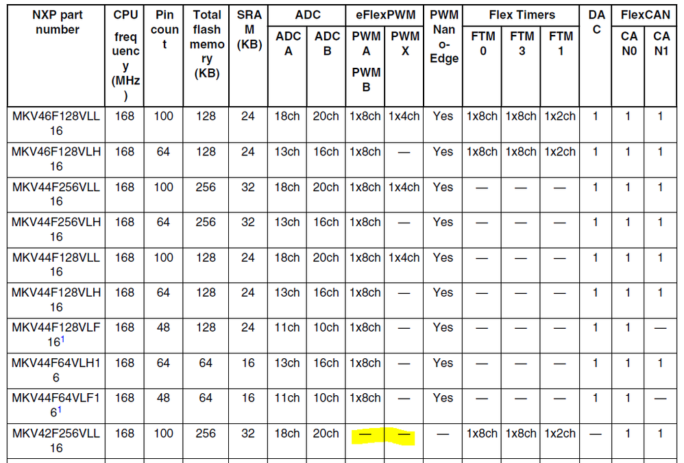

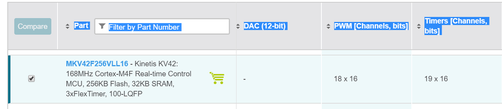

As shown below, the NXP web site indicates that the MKV42F256VLL MCU has up to 18 PWM channels.

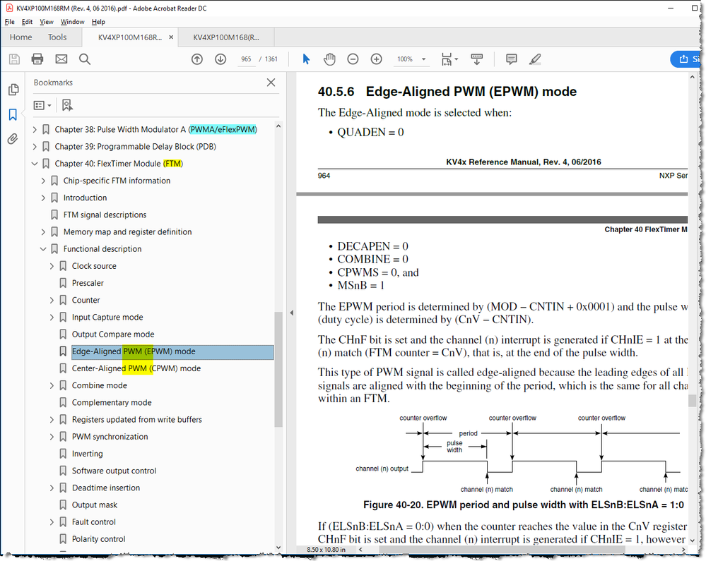

pastedImage_1.png However, as shown below, the KV4x Reference Manual indicates that the MKV42F256VLL MCU has no PWM outputs.

Although the KV42 doesn't have Chapter 38 Pulse Width Modulator A (PWMA/eFlexPWM) module, but the Chapter 40 FlexTimer Module (FTM) can be used to output PWM waveform too.
