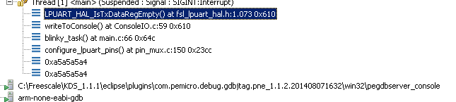

1/ Use Hal UART directly
But It hungs up on LPUART_HAL_IsTxDataRegEmpty (always false).

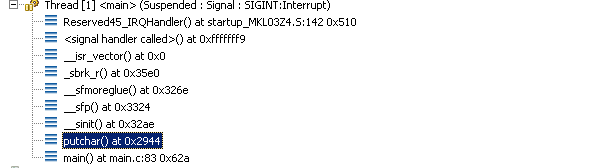

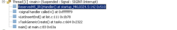

2 / Use fsl_debug_console.
But it does not solve my issue, and hangs up on Reserved 45_IRQHandler(). ( issue occurs even if I printf first or wait for task creation)

I loaded your binary and could see that the code was spinning at the location that you reported (from the map file it is towards the end of the function writeToConsole()).

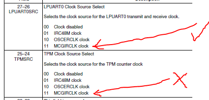

The problem is that the LPUART is not receiving a clock - your system is using the IRC8M (rather than IRC48M) and I suspect that the intension is that the LPUART is to be driven from the MCGIRCLK output, which is the same frequency as the IRC8M.
However the LPUART's clock source is selected in SIM_SOPT2 using the LPUART0SRC field. This is 0 by default and so disabled. I see that the register has been written to 0x03000000 - compare with the following table:
As is seen the clock source to the TPM (Timer PWM Module) has been selected to use MCGIRCLK (b11) but the LPUART0 is still at b00 - disabled).
I manually changed this to 0x0c000000 with the debugger and then the LPUART send the data out and no longer hung in the routine.
Therefore my conclusion is that you either selected the TPM by mistake or else the code generator made an error in selecting the clock source - rather than selecting it from the LPUART it selected it for the TPM module.

The KL03 has 2k of SRAM. Are you sure that you can use FreeRTOS with this amount of memory?
Check stack and heap settings carefully because if anything runs out of memory probably crazy things will happen.
The KL03 doesn't support the interrupt vector 45 so I suppose your code must be landing there after using an uninitialised pointer or such that happens to result in a jump to that location.

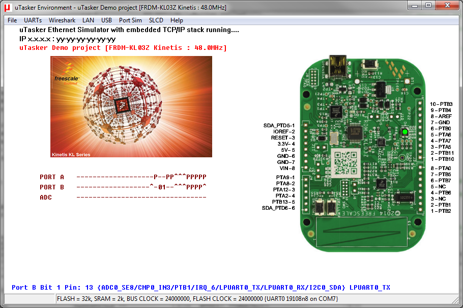

I have attached the uTasker project V1.4.8 build for the FRDM-KL03Z as binary. This can be easily loaded using drag-and-drop onto the hard disk that shows up when the board is connected via USB. Its UART is set to 19200 Baud, due to the large capacitor on the LPUART0_RX line, so that the command line menu can be used without having to remove it. There are various menus that allow various things to be done with it - the acceleropmeter is being samples too (enable output in the I2C menu).
Below is a screen shot showing the board running in the uTasker simulator (which enables fastest development capabilities).
