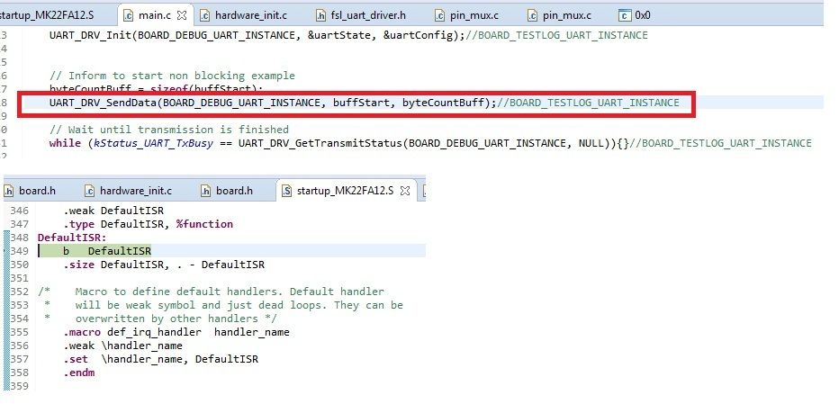

I am using MK22FN1M0AVLH12 processor, copy the part code of the No-Block UART example of frdmk22f in V1.3 KSDK. The SW hold at send function, seems that send function can't find the correct ISR.
My question is,
  1. Why have the above issue? Should some place define interrupt vector?
  2. What evaluationd board is for MK22FN1M0AVLH12? TWR-K21F120M?
  3.  I use wrong code? Not the code from frdmk22f?
Kent

Hi Kent,
    Your problem is mainly caused by the mismatching between your chip and code.
Answer your 3 question in details:
1.Why have the above issue? Should some place define interrupt vector?
If the code and the chip is mismatching, when the code access the area which the hardware don't have, then it may enter in the defaultISR.
2.What evaluationd board is for MK22FN1M0AVLH12? TWR-K21F120M?
 You can refer to TWR-K21F120M, but you should better refer to
TWR-K21F120MA|Tower System Board|Kinetis MCUs|NXP

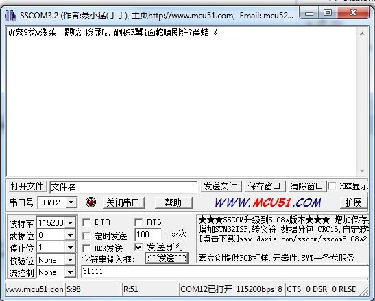

yes, I creat KSDK V2.0 UART example, do as following,
  •  Downloaded KSDK V2.0 for MK22FN1M0AVLH12
  •  Use "Kinets SDK 2x project" wizard to create empty project for MK22FN1M0AVLH12
  • Copy part code from "KSDK_2.0_MK22FN1M0A\boards\twrk21f120m\driver_examples\uart\interrupt_transfer\kds", include some part from uart_interrupt_transfer.c, board.c, board. h, etc.
  • Change UART5 to UART1 because I design a new board using MK22FN1M0AVLH12
PC COM tool can receive the data from the board, but have the below question,
  • Data is not right as  string in code. I try to change baud rate in PC COM tool, but can't work.
  • PC COM tool can't realize Rx/Tx loop function base on FW SW should have Rx/TX loop function.
Kent
3,078 Views
kent_gu
I think I have found the reason. The reason is baud rate is wrong in the example, which is caused by "#define DEMO_UART_CLKSRC kCLOCK_BusClk", and get 60M, which cause wrong. If use "#define DEMO_UART_CLKSRC kCLOCK_CoreSysClk", then can fix make the example wrong well.
