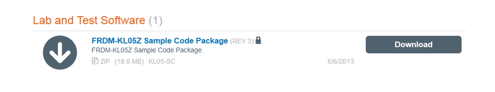

Hello ION,
- There is FRDM-KL05 sample code package ,  it have UART driver, after you download it , you can find here :
KL05-SC\KL05-SC\klxx-sc-baremetal\src\drivers\uart
you can download it here :
Freedom Development Platform for Kinetis MCUs|Freescale

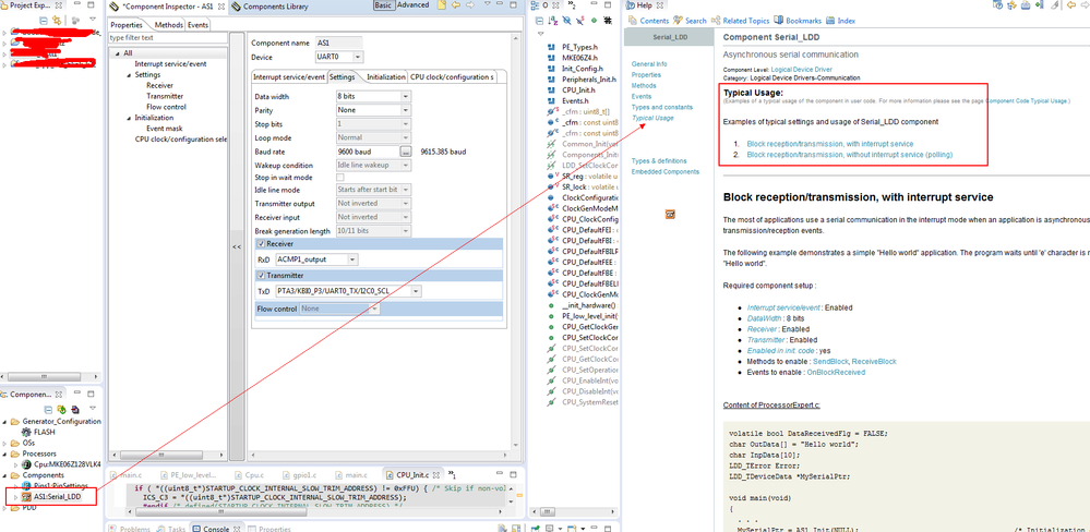

-  And why you do not use Processor Expert , it is a good tool help you develop the project , there also is sample code about how to use it .
For example : add the component "Serial_LDD" , right click it , you can find "help on component" , then in the  "Typical Usage" you can find
how to configure it and the demo code :
Hope it helps
