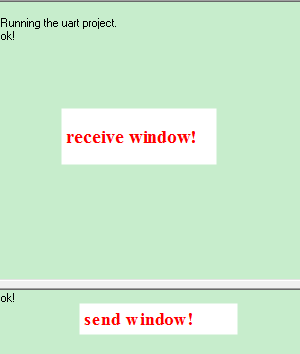

kerryzhou
Hi Nhat Minh,
    I checked your project, but I didn't find your error"No source available for "__udivsi3 (0x00000828)() ". it stop in  uart0_init function.
    I think it is the configuration error.
    Now, I do a uart project based on PE of Codewarrior 10.6. and it works OK.
    Please find my project from the attachment.
    My project function is : when receive the character from Computer and send back.
  My test platform is FRDM_KL05.
  UART BAUD IS 9600 bps.
  The test result is as follows:
  Wish it helps you!
If you still have question, please contact with me!
Jingjing

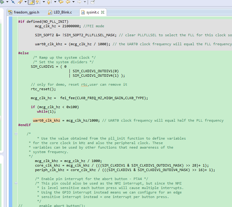

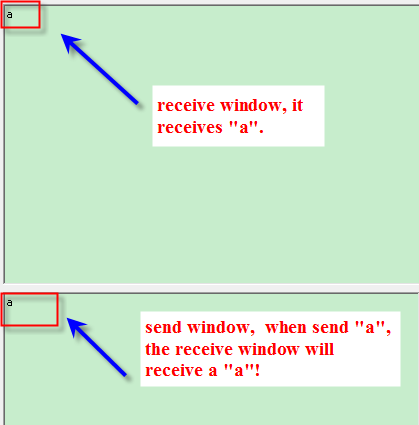

kerryzhou
Hi Nhat Minh,
      You project is incomplete, you didn't configure the mcg clock,  the core clock, peripheral clock ect, and this is the most important to the cup.
      Attached is a new prject, and the main is neally the same as you, just add the sysinit() to configure the system clock, for details, please see the sysinit function.
     Besides, you need to read the MCG chapter in our reference manual.
    My baud is 19200 bps, and the test result is as follows:
Wish it helps you!
If you still have question, please let me know!
Jingjing

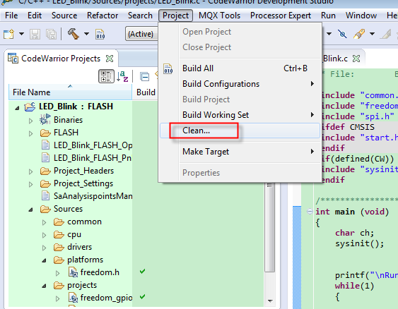

kerryzhou
Hi Minh,
   Please do the clean project at first, just like follows:
then build it again!
Jingjing
