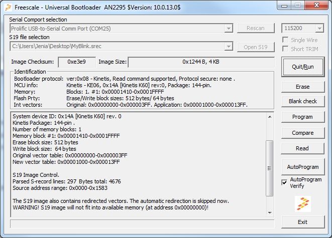

Hello all,
Eventually I decided to follow up "UART Boot Loader Design on Kentis E Series" document.
I have KE06Z128. I've downloaded AN4767SW and integrated it in KDS and configured UART for communication.
Also downloaded AN2295 PC side host GUI for tools to decode the  s19 file and transfer the application code to target MCU by UART interface.
When I run with debugger and connect to the AN2295 GUI, it communicates and get the IDENT info:

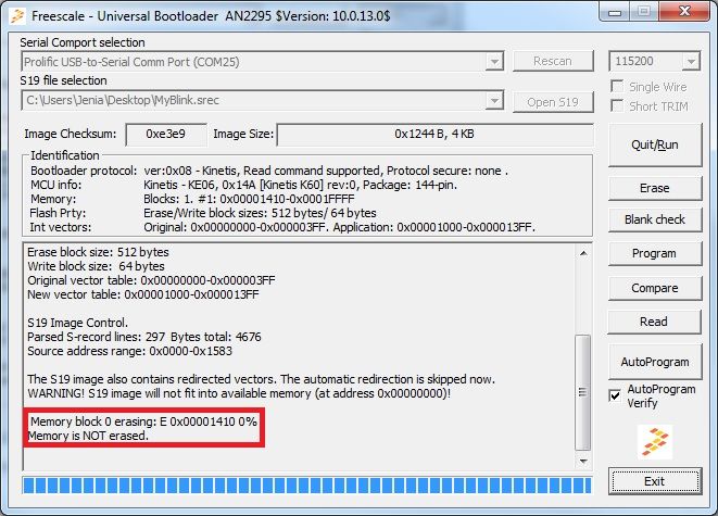

But when I'm trying to 'Erase' or 'Program' it fails:
my configurations from FC_protocol.h:
MyBlink.srec is just mine little program to test the serial boot loader, I've test it, work good.
What could be the problem?
Jenia.

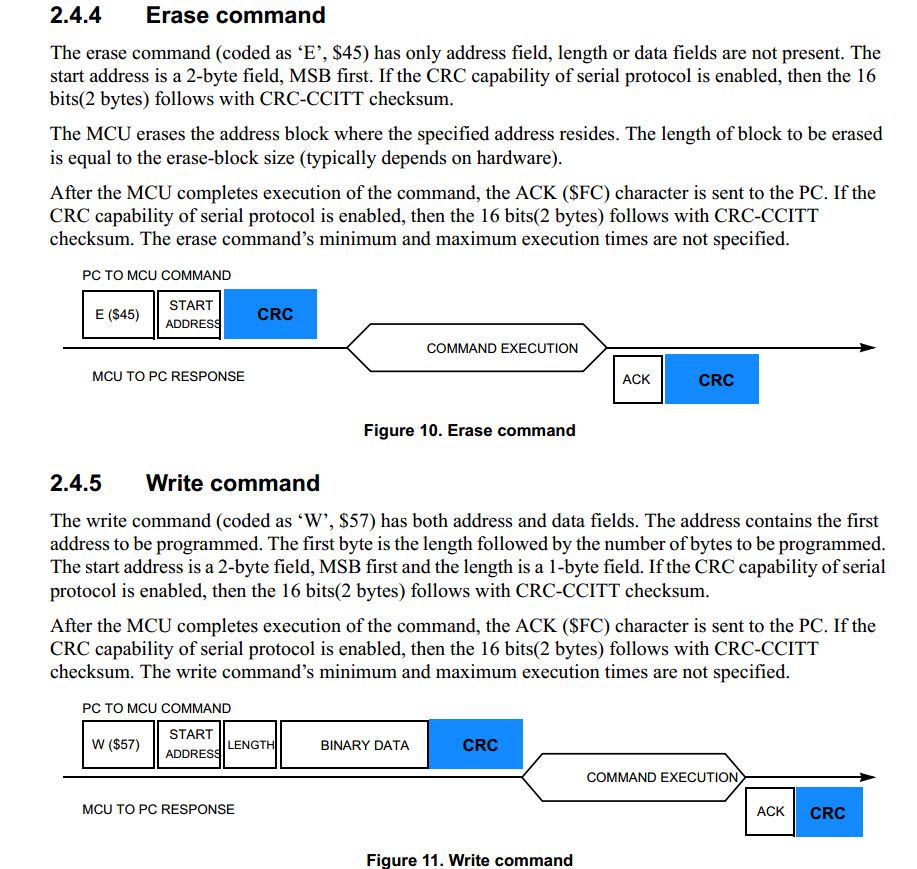

Hi Jenia,
Regarding to the kind of issue, I'd highly recommend you to capture the waveform by oscilloscope when click the Erase and Program buttons, then compare the captured waveform with the Fig 1 illustrates.2016-07-05_19-01-05.jpg
Hope it helps.

jeniabrook
Thank you.
The problem was in communications. I've checked accordingly to the protocol that you posted here, the address that I received was wrong maybe due to polling in UART.
Switched to interrupts in UART and that solved the problem.
