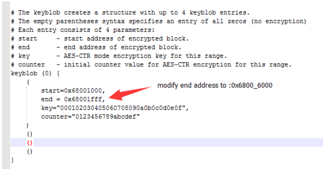

Customer just need to set the keyblob structure with correct start address and end address.
The keyblob structure with up to 4 keyblob entries supported, which customer can use to place ecrypted data to those memory range.
The plain text data also could be placed to QSPI, for example split encrypted data vs. plain text data with different QSPI memory address:
such as:
encrypted data: 0x6800_1000 - 0x6800_5000
plain texted data:0x6800_6000 - 0x6800_F000
Then modify qspi_image_encrypt.bd's end address to the end of your encrypted data with address: 0x6800_6000
the KBOOT will automatically  record those start/end address and fill into OTFAD registers to make sure that
0x6800_1000 - 0x6800_5000 will be decrypted while data in 0x6800_6000 - 0x6800_F000 will flow into CPU directly.

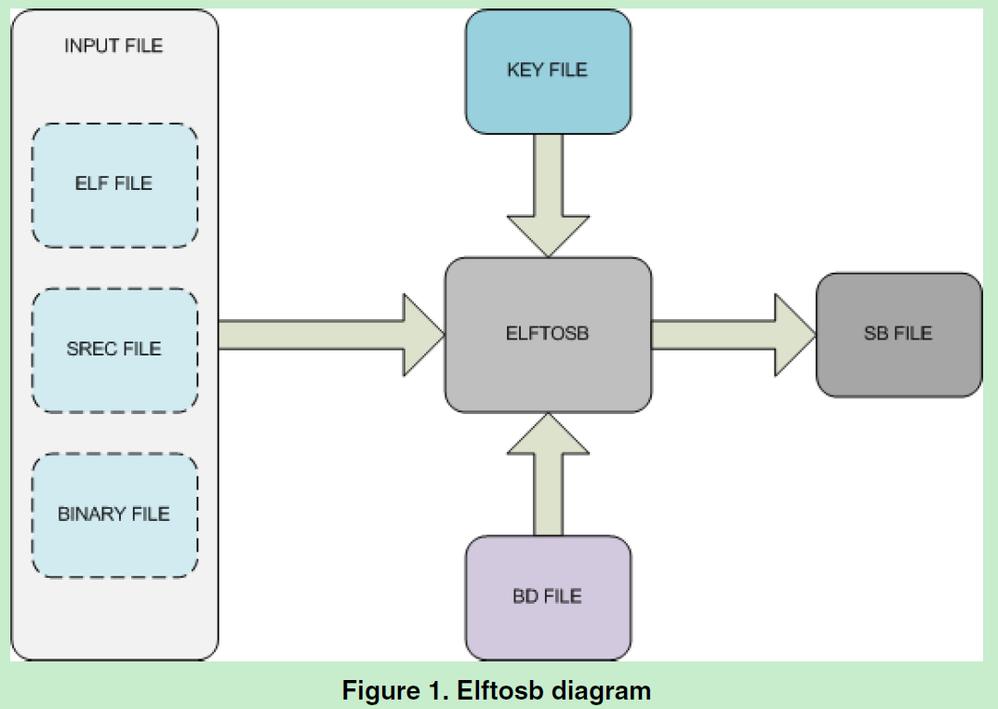

NXP provide the Elftosb tool help to create a "secure binary" for SB file to place to QSPI memory range.
Customer could find more detailed info about Elftosb tool with Kinetis bootloader v2.0 software and related document.
