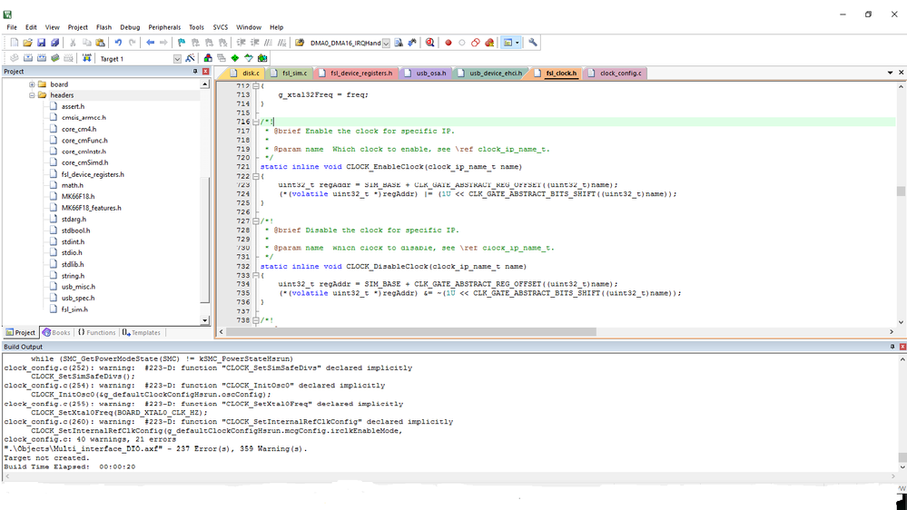

Now I tried to extract the code from SDK2.0 stack to create my own project, but it was giving number of error. I just created empty project and copied all file including start up files and all header file from stack.
How do I create my own project in our specified folder, and I don't want to link header files from other place, all the files I am using need to be in my project folder.

You can download the project generator tool from KSDK page and use it to create or clone a KSDK based project. It can be a standalone project.

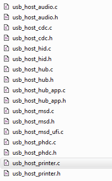

>> If I use USB1(USB-HS) in host mode, Can I connect USB hub of 1:4 or 1:8 to the USB port. If so which of example I should use in  SDK_2.0_MK66FN2M0xxx18 stack.

I think you can use any of the SDK2.0 example for USB host demos. Hub support is inherent with SDK2.0 stack. You can find hub support code under middleware\usb_1.4.0\host\class folder.

In SDK2.0 example I found USB host CDC,audio,Moss storage disk,HID mouse & PHDC example. How do I start with these example so that I need to connect USB hub of either 1:4 or 1:8. And through that USB hub Can I connect Multiple USB device like Mouse,USB Moss storage device or any other USB devices.
> Can I configure USB hub to connect different class device.
>> Now I need to use both USB0(USB-FS) as VCOM device and USB1(USB-HS) in Host mode to connect USB hub. Does it possible with MK66 MCU or else I need use any USB controller.
I worked on USB device mode but very New to USB host mode.
Can you please clarify me about these things and track me how do I start. ?

OK, I got what you mean now. Current SDK USB host demo support is one example code just support one USB class. You need to change code to have it support multiple USB class. I have not tried such use case yet so I do not have much comment on how to change.
For your use case, it's possible, you can use USB-FS as USB device while USB-HS as USB host. But you may need to consider if the USB device is self-power or bus-power and how you can make sure the USB regulator output works for both USB module.
