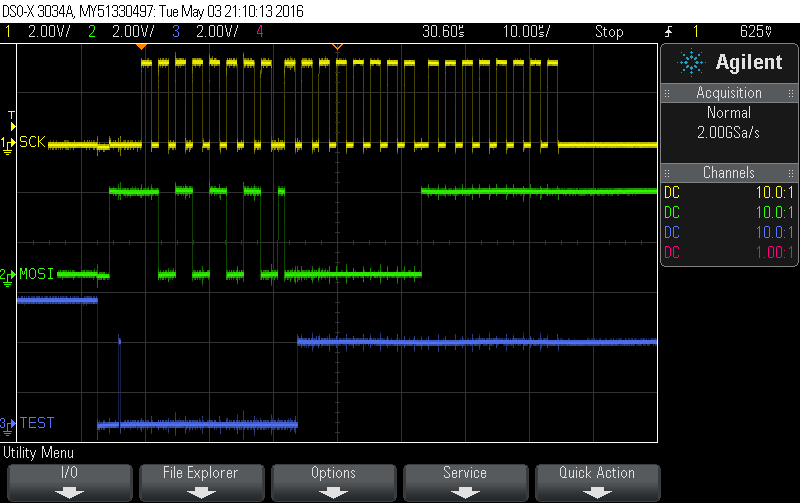

I am working on a project using a Kinetis K64F microcontroller and am having some trouble detecting the end of an SPI transmission. I use Kinetis Design Studio 3.2 and Processor Expert. The microcontroller, an MK64FN1M0VLL12 is on a custom PCB. What I am experiencing is the following:
I would like send 3 bytes on SPI, where the master is the microcontroller. I set up an output buffer and call the PEx function SPI_SendBlock(). Then I would like to block the program until the transmission of all 3 bytes is done. For this purpose, I call the PEx function SPI_GetBlockSentStatus() in a loop and exit it when the function returns true. However, the function seems to return true well before the transmission completes. In fact, it returns true right after the first byte has been shifted out.

I am using a BitIO component (named TestOut) to determine when the program passes the line "while (!SPI_GetBlockSentStatus(SPI_DeviceData));". Capturing the signals with an oscilloscope, I see this:
It can be seen that data transmission works fine, but the TestOut pin (blue channel on the oscilloscope) is asserted after the first byte has been transmitted on the SPI bus.
My question would be: Am I misunderstanding the aim of the function SPI_GetBlockSentStatus()? Shouldn't it indicate the very end of the SPI transmission? Could you help me finding out what I am doing wrong?

Hi Daniel Nagy
There is a bug in the SPI PE driver. It actually set the SerFlag when you push all the bytes in the TxFIFO and it doesn´t wait for the data to be shifted, hence, the Serflag is up before the last 2 bytes are shifted.
You can fix the problem if you use the EOQ (End Of Queue) flag, it tell you when the end of the transfer is reached. To make this you have to mask your Txcommand with the EOQ bit to indicate that what the last byte is. This has to be done before it push the tx data in the interrupt. So in your SPI interrupt:
if (DeviceDataPrv->OutSentDataNum == DeviceDataPrv->OutDataNumReq){/* check if it’s the last byte */
TxCommand|= SPI_PUSHR_EOQ_MASK;
SPI_PDD_WriteMasterPushTxFIFOReg(SPI0_BASE_PTR, TxCommand); /* Put a character with command to the transmit register */
And in your main.c you just have to use the EOQF flag instead of the GetBlockSentStatus.
//while (!SPI_GetBlockSentStatus(SPI_DeviceData));
while (!(SPI_PDD_GetInterruptFlags(SPI0_BASE_PTR) & SPI_SR_EOQF_MASK));
And everything should works fine.
