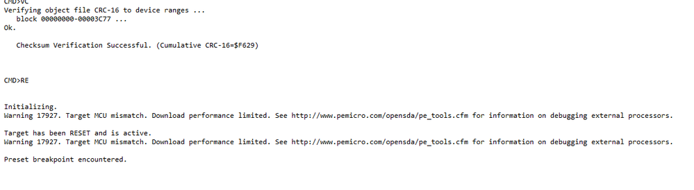

Using Kinetis Design Studio 2.0.0 and KSDK 1.1.0, I followed the steps to build the KSDK libraries and I've imported the Hello World demo from KSDK_PATH/Demos/hello_world/kds/twrk64f120m. I then cleaned and built the project which finished successfully. I plugged in my TWR board to the OpenSDA/Power usb port and selected the pre-configured debug profile "hello_world_twrk64f120m debug pne" to debug. No errors occur during the programming but I do get a "Warning 17927. Target MCU mismatch. Download performance limited" message in my console:
Execution breaks upon entering the main function as expected, but as soon as I hit continue I immediately break in the Reset_Handler section of startup_MK64F12.s (line 328). Trying to continue just loops me back to the start of the Reset Handler. Additionally, I'm not seeing the "Hello World" output in my serial terminal (set to 115200 baud rate on COM 5. Verified COM5 is the port associated with the board and is using the "OpenSDA - CDC Serial Port" driver according to Device Manager) - I've also verified that the jumpers on J10 and J15 are set to route UART1 through the OpenSDA chip.

Also I stumbled across this thread "No source available for "0x530" error, and found a solution to the "Target MCU Mismatch" by updating the OpenSDA firmware to the DEBUG-FRDM-K64F_Pemicro_v108b_for_OpenSDA_v2.1.bin (which I hadn't tried originally because I'm on a TWR board not a Freedom board, but oh well).
However I'm still getting the reset issues.
