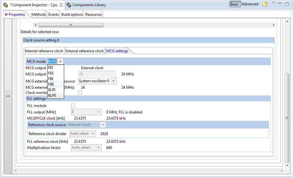

There doesn't seem to be a combination of clock settings that would produce 48MHz. Best I could get is 47.97 (which should be good enough for device although not for host). However when I set this up in PE window (I am using KDS studio PE project), when generating PE code I get an error message:
Generator failure. Unexpected status of script Doxygen\Common\DoxyGenComponentProg.prg. Please contact Freescale support.
Not sure if the error message has to do with the warning about the USB clock not being exactly 48 MHz though
On MK22F512 there are two extra choices fro MCG settings that are not on MK22F128. I wonder if there are some limitations with MK22F128FN with regard to USB that do not exist for MK22F512

The K22FN128 doesn't have a PLL (only FLL) and so I suppose the tool is right in not allowing it to be set up.
As noted, the FLL has high jitter and will not allow passing USB certification.

Kan_Li
Hi Alex,
I agree Mark, you might use the FLL instead to generate the USB ref clock, and I also made a KDS project according to your requirement, and looks like no problem during the compiling, please kindly refer to the following for details.
Please kindly refer to the attached KDS project for more details.
Hope that helps,
Kan
3,920 Views
Kan_Li
Hi Alex,
I am sorry, seems I used the wrong device, and when I tried to use the device of MK22FN128VMP10, I found  the MCG can not be set in PEE mode, I am thinking it might be a KDS issue, alejandrolozano, would you please look into this issue? Thanks in advance!

It appears on the low-end devices such as MKF22128VMP10 I am using the only reasonable option for USB operation is the internal 48MHz clock (IRC48). It can be selected as the USB clock source in Advanced mode. This works for higher-end SKUs as well. I was able to get the system configured and partially work, although I ran into another problem that I will post about separately.

For USB device mode the IRC48MHz clock can be used with its crystal-less operation.
I suppose the 49.97Mhz is derived from the FLL 1464 multiplication from the 32.768kHz crystal. It is not only inaccurate but the FLL doesn't meet the specifications for USB certification and so the only way for host operation on the K22FN128 is to supply a 48MHz oscillator for its USB_CLKIN.
The other K22 parts have also a PLL (MCGPLLCLK) which is suitable for USB host certification but the K22FN128 tends to be "optimised" for lower-cost device-only use.
