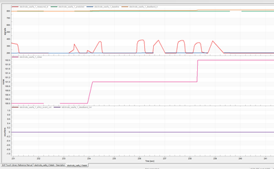

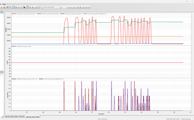

I am facing a strange problem due to the NXP Touch Library available with the NXP SDK.
I am using NXP FRDM-KE15Z with MKE15Z256 micro-controller.
if I use the version 2.10 version of the SDK, the touch_sensing example project works very well with usafa key detector algorithm, below are the screen shot from the FreeMASTER tool.
But in the latest version of the SDK i.e. 2.16, I see there is a new key detector mbw and the project is updated to use this key detector. And when I use this project everything works fine.
But due to some reason I still want to use usafa key detector, so I copied the usafa key detector settings/tuning values from version 2.10 project to version 2.16 example project, and also updated the Electrode_1 and Electrode_2 to use the usafa key detector, and when I started this project, I see that the touch is not working, and the reason is clear, whenever I am touching the electrodes the signal is not crossing the deadband signal, and that's not detected.
I want to understand what exactly is changed in this touch sensing library which is causing this strange behavior (atleast for me), as per my understanding the same parameters should produce same results, as I am using the "usafa" key detector only.
The following is the screen shot of FreeMASTER with SDK version 2.16 and Electrode 1 and 2 updated to use usafa electrode with settings/tuning values copied from version 2.10
Also as I can see the values are also different.
I am also sharing the updated nt_setup.c file, just wanted to inform you guys that, I am just testing on two onboard electrodes i.e. Electrode 1 and Electrode, I don't have Freedom Touch board, and in project I have set this "#define NT_FRDM_TOUCH_SUPPORT 0".
The changes I did are just adding these lines.
