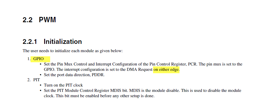

kerryzhou
Hi Shaul,
   I checked the AN4419, please check this description:
So, it seems, it should work with both edge.
If you just can work with 3, DMA request on either edge, rising edge can't work, I suggest you also enable the pin internal pull up.PORTX_PCRn[PE]=1, .PORTX_PCRn[PS]=1, then try  it again.
Kerry

shauldorf
Contributor V
Hi Kerry
In AN4419 page #8 you can see that configuration is rising edge.
Triggering on dual edge will produce double frequency compared to rising edge .
My IO port PTD0 (J2_6) is an output port so pullup doesn’t solve the problem because it is used for the input pad.
In my attached demo today I found a problem that after power up it also doesn’t work until to run option with DMA  of 8 bit(byte) width. It is in attached (BarePIT_GPIO_ByteOpt_AN4419.zip).
Then you can run my first zip project (Bare_PIT_GPIO_AN4419.zip) that is 32 bit DMA.
This is that at power up TCD registers are undefined.
So I think that there is something wrong with my DMA TCD, the first BarePIT_GPIO_ByteOpt_AN4419 pre-configs well.
In second run of Bare_PIT_GPIO_AN4419 it uses the previous setup and every thing is OK.
But this doesn’t solve the original question  dual/single edge triggering .
Shaul
