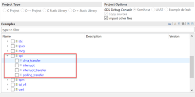

Hello Frank,
Hope you are doing well.
I recommend to use the examples in the SDK for the FRDM-KL26 which support MKL16. Here you will find four different examples using spi.
You may use these as a reference to get your application working for the device you are using.
The SDK can be downloaded from MCUXpresso SDK.
Please let me know if you have further questions.
