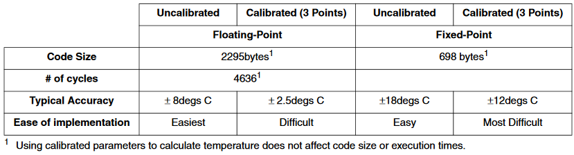

I need good accuracy in the 75°C to 100°C range.
Reading through Freescale's (NXP) Application Note AN3031, I see the following table:
I am uncalibrated and using fixed-point. Say my "actual" temperature is 82°C. So what exactly does this ±18°C mean?
1) Does this ±18°C represent an error across the entire temperature range, or just the extremities (25C has much less error whereas 85C has ±18°C)???
2) Is this accuracy within the same chip (my sampled readings can range from 64°C to 100°C when the actual temperature is 82°C), or does it represent the error from chip to chip, or even reel to reel?
I think it means the extremities.
The table illustrates the different data process algorithm affect the accuracy of the temperature sensor implementation for the HCS08, however it doesn't suit for other devices likes the Kinetis series.
Ping
5,313 Views

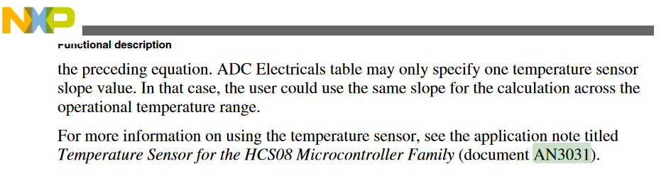

rampsr
If the data in the table only describes the HCS08 and not the Kinetis, then Freescale/NXP need to correct their literature.
This is from page 458 of the "KL05 Sub-Family Reference Manual" for the "KINETIS" microcontrollers
Well, I'm seeking "more information on using the temperature sensor".
If the Kinetis is different, then can someone from Freescale/NXP answer the question?

jeremyzhou
Even in the series of the Kinetis, the ADC module is also not same.
And the ADC operation modes are great variety too.
It's impossible to illustrate parameters in a table which can be suit to all ADC operation modes.
So I think the table in the AN3031 is more mean to compare the differ ways to calculate the temperature.
Hope it helps.
