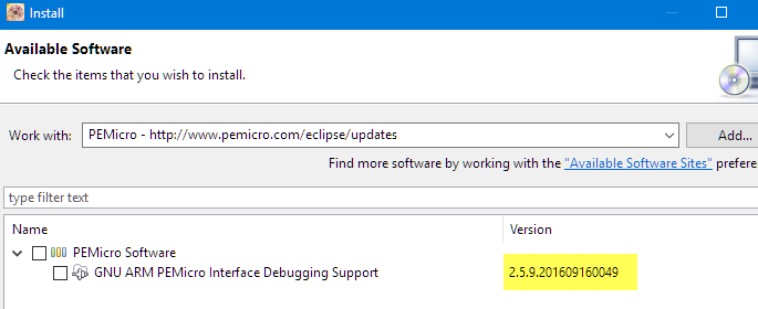

BlackNight
When you debug it with the the P&E software (e.g. through Kinetis Design Studio), it will automatically update the firmware on the P&E Universal Multilink. I recommend that you use Kinetis Design Studio V3.2.0.
Make sure you have the latest P&E software (in Eclipse: Help > Install new software, then point to the http://www.pemicro.com/eclipse/updates  update site.
Erich

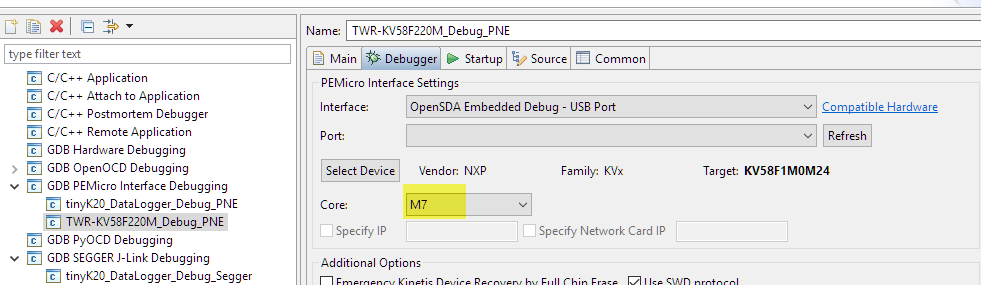

Hi Erich,
Looks like I can't choose core "M7"...
Christie
10,145 Views
BlackNight
The core should not matter (it is indicative only). It is preset to M7 for me (I cannot change it):
Are you really using the latest P&E software?
Erich

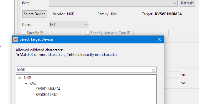

Hi Erich,
If I re-select "KV58F1M0M22" instead of "KV58F1M0M24", I can select M7 core mad works fine for programming.
Could you tell me what I need to update?
Christie
10,141 Views
a8Chcx
Contributor V
Hi Erich,
I am using KDS 3.2.0 and KDSK 2.0 for TWR-KV58F220M. I have to select KV58F1M0M22 instead of KV58F1M0M24 to make debug work.
Could you tell me if I need to do updating on KDS 3.2.0 and how?
There is any problem if am using KV58F1M0M22?
Christie
10,141 Views
BlackNight
If you are using the latest P&E software, then only this should show up:
Can you confirm you have installed this version:
