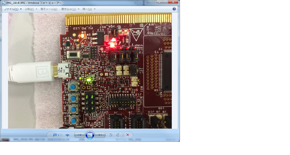

When connecting the host PC and TWR-KV58F220M , the red LED near J25 will light up.
The same thing happens even if I connect again.
I can not write software using Mbed.
Please tell me how to solve it.

From your pictures, your chip is secured to the highest level, then you can't unlock the on board KV58 chip any more, you need to remove the board KV58 chip and solder a new KV58 chip.

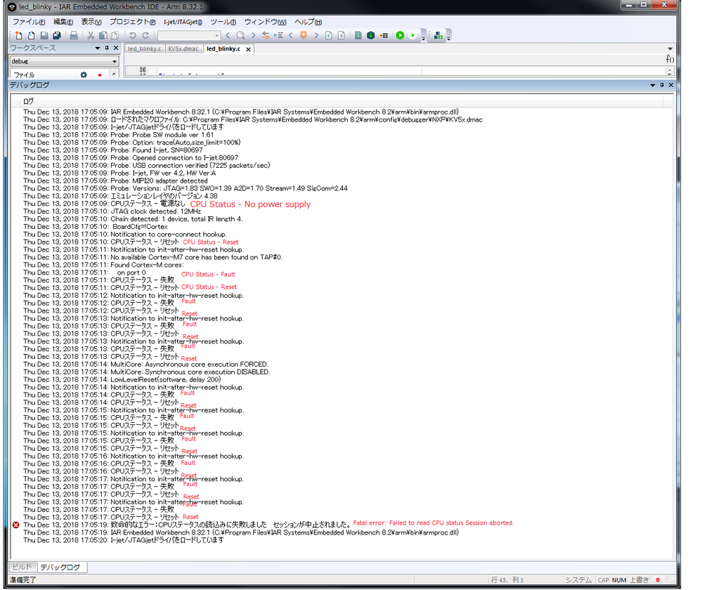

katsuta_takehiko
Thank you for your reply.
J18 connected, and J17 shorted.

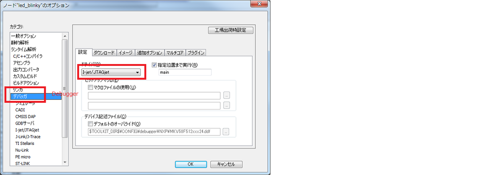

I only have I-Jet.
I did it with the following settings.
After pressing the "Download and debug" button, the following error log was output.

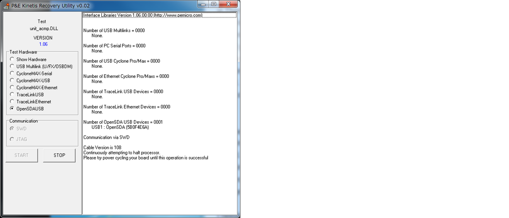

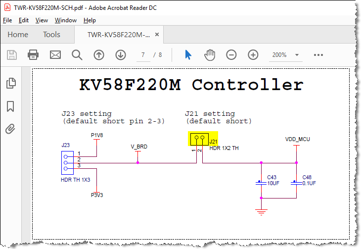

Robin_Shen
CPU Status - No power supply
Please check the voltage of VDD_MCU(J21 and J23 should be default)

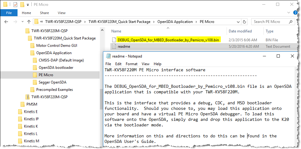

I only have I-Jet.
You can reprogram OpenSDA adapter with some new debug, serial, MSD flash-programming application.(For example: P&E Micro firmware)
Then the Kinetis_Recovery_Utility can be used.

katsuta_takehiko
I could connect to the screen below.
after that
I connected and disconnected the USB cable many times.
In addition, J21 also pulled out and pulled out many times.
However, no response.

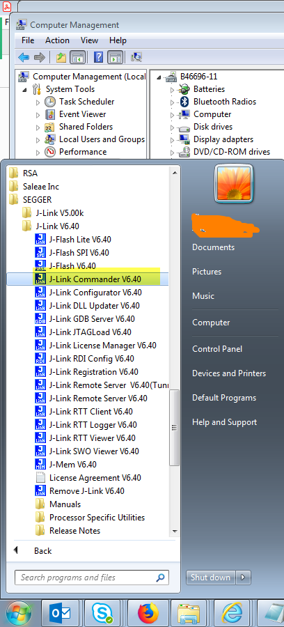

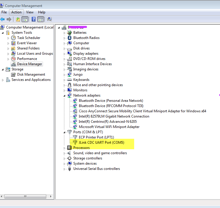

kerryzhou
Hi Takehiko Katsuta,
    I take your case which is the same question as this post.
    Now, I give some comment about my opinion.
  D6 red LED is on, when the KV58 MCU flash is empty, it will also be light.
  Now, please check these points:
1. Check the J21 voltage with the multimeter, whether it have 3.3V or not?
2. Connect J18, then change the on board debugger firmware with JLINK, please follow my way to change it.
   1) download the JLINK driver and install it, the linker is:
    SEGGER - The Embedded Experts - Downloads
   2) Download the JLINK debug firmware from this link:
   3) Power off the board,  press the reset button, and hold on it, then plug the usb cable, you will find your board is a device named as "bootloader"
Then send the "OpenSDA_V2_1.bin" file to the BOOTLOADER, and wait the sending  is finished.
  4) power off the board, and power on it again, then wait the install finished.
    You can find your device is the JLINK from the device Manger
  5), Now use the JLINK commander to connect your board
  Now follow my instructions:
Check it whether you can find the Cortex-M7 core or not?
If you can't find it, please input: unlock kinetis
Whether it can have the unlock OK?
If you still not OK, please send me your screen shoot about the JLINK commander window.

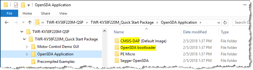

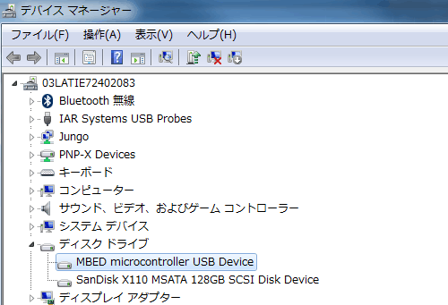

Would you please show me if the MBED is well installed in Device Manager?
The default bootloader and CMSIS-DAP firmware application can be found in TWR-KV58F220M-QSG.

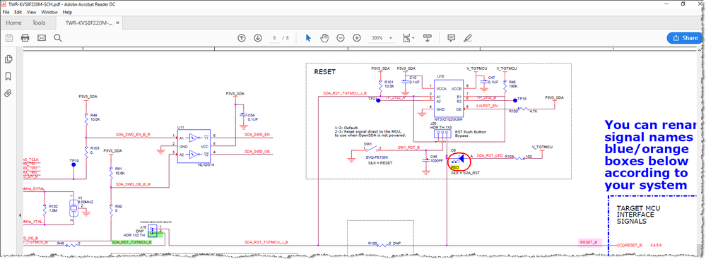

The RED lED shown the state of RESET_B.
You can check if the low voltage is caused by SDA_RST_TGTMCU_R or MCU itself.(After cut the trace on ON BOTTOM LAYER, measure the voltage of Pin2 J18.)
If the low voltage is caused by MCU itself. The Kinetis_Recovery_Utility can be used to recovery: Bricking and Recovering FRDM-KL25Z Boards: Reset, SWD Clock and Low Power

 MBED is recognized.
 Host PC is Win7. IDE is using IAR.
 I cut J18 but the LED is on.
 So I think that the MCU itself is bad.

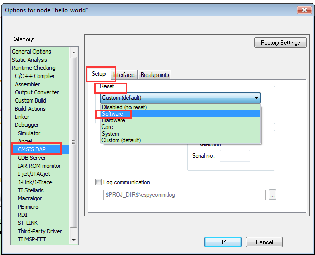

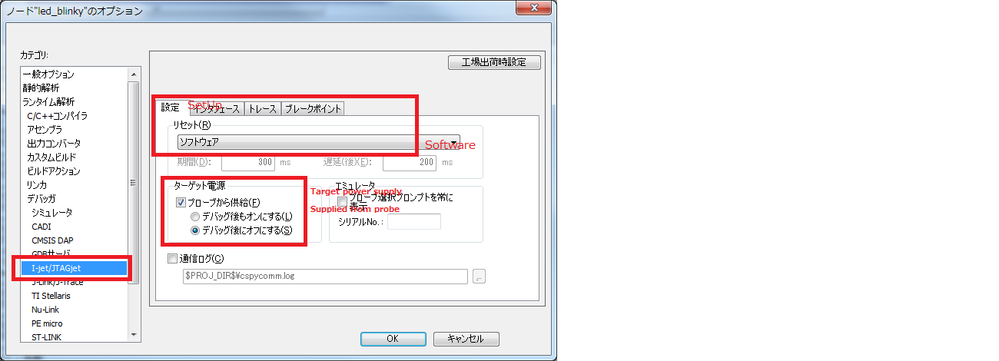

Robin_Shen
Ok. Please connect J18.

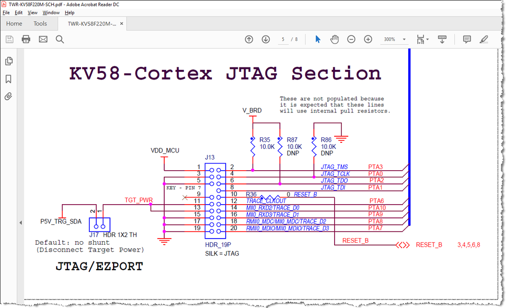

And try to: Change the reset method to Software.
Additionally the J13 JTAG port can be used to program with your I-Jet.
