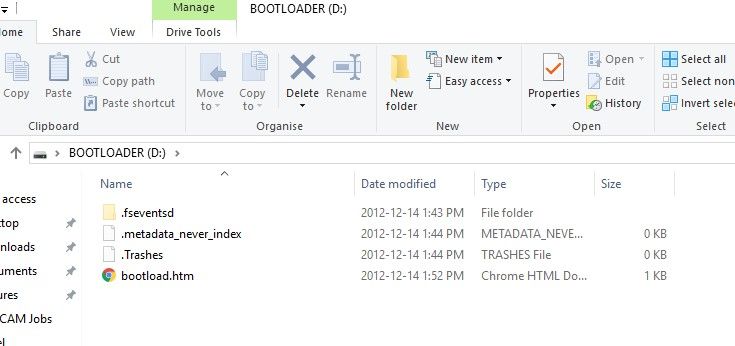

The issue is that when I plug the board into my laptop it doesn't appear as a MBED Drive and the virtual COM Port isn't created. But the LED blinks when I tilt the board so I know that the MCU is working and is running the demo code. I've tried going through the OpenSDA documentation and I've found that my bootlader doesn't match what is shown in the documentation (Figure 2).
                                                  Figure 1. Bootloader from my TWR-KV58220M board
                                           Figure 2. Bootloader shown in the OpenSDA documentation
I've tried copying bootloader files for J-link and the default Open SDA but to no avail. Any insight into my problem would be appreciated. Also I should be able to get around this issue by using a compatible programmer right?

Yes this is my underlying issue, which would then prevent me from programming the board over OpenSDA. I have already done what you suggested since this was how I got the the bootloader drive I showed in my post. My computer does recognize the board as a MBED device but no virtual COM Port is created.

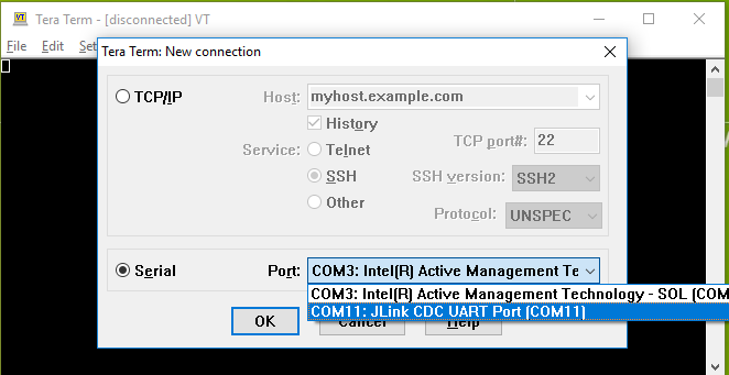

Here is what I did in order to have to COM Port created for the board:

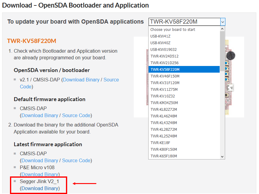

1) Go to the following link: https://www.nxp.com/support/developer-resources/run-time-software/kinetis-developer-resources/ides-f...
2) Select the TWR-KV58 Board and click to the Segger Jlink V2_1 Option:
3) Download OpenSDA V2.1 Bootloader from the J-Link OpenSDA - Generic Firmwares (you'll find this at the link you are redirected when selecting the option mentioned in the previous step):

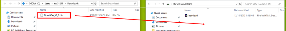

4) Connect your board to your PC with ISP mode and drag/copy the bin downloaded in the previous step into the BOOTLOADER of the board:
5) Unplug and plug the board again, and you should see that the virtual COM Port is now created (COM 11):
I hope this small guide can help you with your issue.
