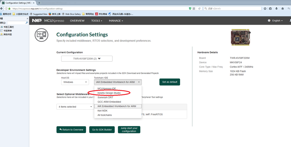

xiangjun_rong
Hi, Christie,
As you know that you can select the tools for example MCU Expresso, KDS, IAR....as the following figure when you Build the downloaded package.
Xiangjun Rong

xiangjun_rong
Yes, I have downloaded the package and unzip it to a directory. It seems that all example are based on IAR tools although I select KDS tools when I build.
XiangJun Rong

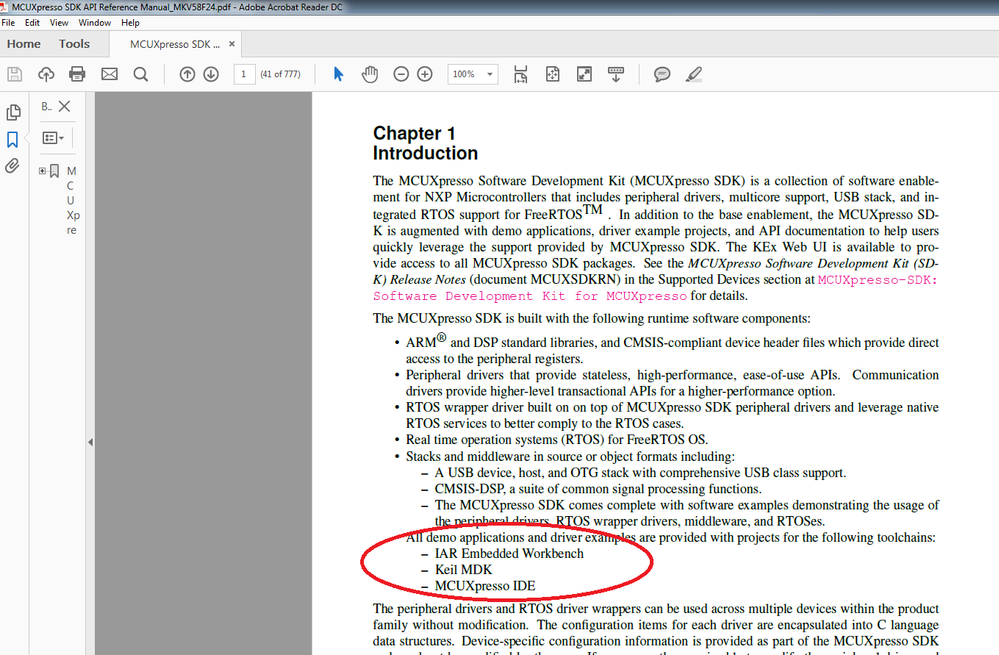

xiangjun_rong
Hi, Christie,
The current SDK2.2 for TWR-K58F220M does NOT support KDS tools, pls refer to the lines:
All demo applications and driver examples are provided with projects for the following toolchains:
– IAR Embedded Workbench
– Keil MDK
– MCUXpresso IDE
which is listed at page 1 in MCUXpresso SDK API Reference Manual_MKV58F24.pdf.
Hope it can help you
Xiangjun Rong
