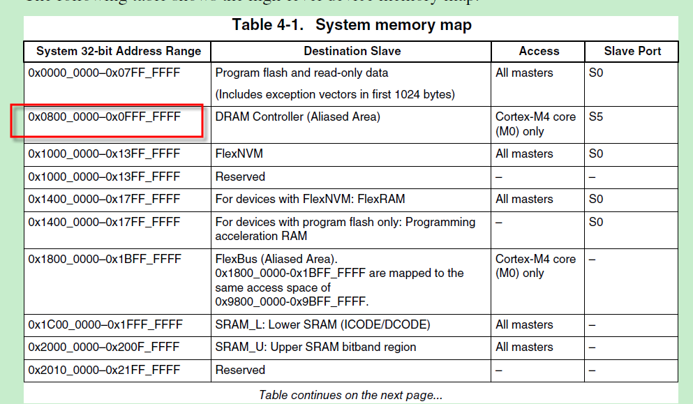

TWR-K70  (  DDR2 size bytes ? )
BASE_0x80000000 ~ 0Xxxxxxxxx ?    ( kbytes )
my data  ( byte 8bits )
thanks,
Carlos.
1,539 Views
kerryzhou
Hi carlos candido,
    From the K70 reference manual, you will get the following information about the DDR address space:
