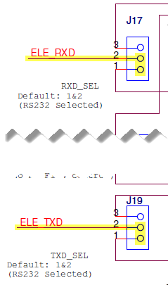

Is this the same case for TWR-K20D72M and TWR-SER? I'm getting signals on the Tx pin of the K20 but not from the final Db9 connector..
H.S.Srinivas
2,379 Views
Jorge_Gonzalez
Hello Srinivas Himakuntala:
Yes, it is the same situation. In this case for TWR-20D72M  the pins PTE0/PTE1 for UART1 are shared between OSBDM virtual port and TWR-SER. As Melissa mentioned, there should be no problem as long as you only use one interface.
If you do not see the signal in DB9, check the jumpers J17 and J19. Both should be in position 1-2. Also make sure that TWR-SER has power.
