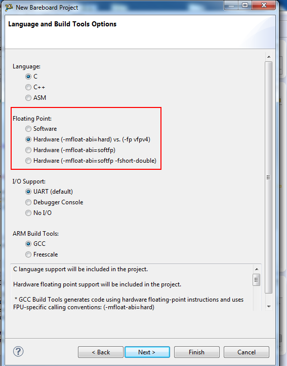

Dear sir, I have a TWR-K21F120M
But, when I want to use floating-point operations, there will be an error
Thank you very much ~~

Hello 佑煊 黃,
Please, check settings in KDS.
these documents could help you solve your problem:
Printing Floating point values to fsl_debug_console FRDM-K64F
and printf() with float values
I hope it helps,
Iva

Hi 佑煊,
Do you use CW10.6 ?
In you screenshot , where show the float error ?
And about the float configuration on CodeWarrior, you can select on here :
And i have test on my side (mk21fn1m0 - CW10.6), when define like your code (float tt; tt = 2.0f),  it can work well.
So could you show detail the float error .
Alice
