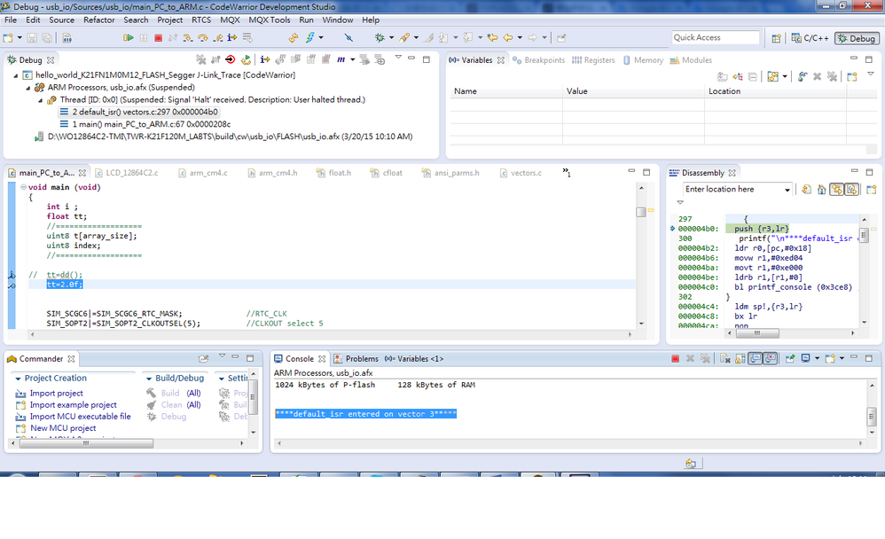

Dear sir, I have a TWR-K21F120M
But, when I want to use floating-point operations, there will be an error
Thank you very much ~~

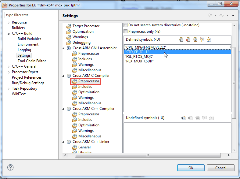

Never mind. Please, try do it by this way:
Change std_prv.h to following:
#ifndef STD_FP_IO//DES added #ifndef
#define STD_FP_IO 0
#endif
and change the value in Preprocessor STD_FP_IO = 1
Iva

I can not find the preprocessor options

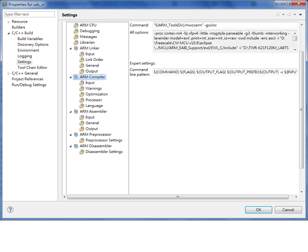

Do you use CW10.6 ?
In you screenshot , where show the float error ?
And about the float configuration on CodeWarrior, you can select on here :
And i have test on my side (mk21fn1m0 - CW10.6), when define like your code (float tt; tt = 2.0f),  it can work well.
So could you show detail the float error .
