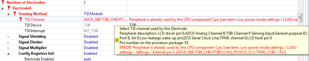

Hello All,
We have another problem arise in our hardware setup. We found out that when you use TSI0_CH0 in external pin 1 in   LLWU settings, you cannot use it as electrode pin in TSS_library component.
Please see below image.
Can it be solved by using the internal module 4 (TSI0) instead? Can somone give an example how to use TSI as internal module. Our product requires to wake-up from LLS mode using TSI in PEx.
