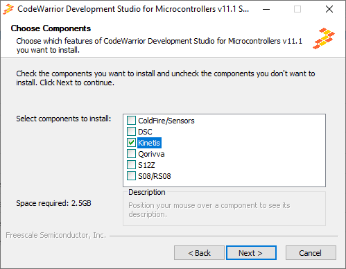

Hi lim,
Sorry for my last reply!
According to the error message, seems that you did not choose Kinetis when install the CodeWarrior.
Robin

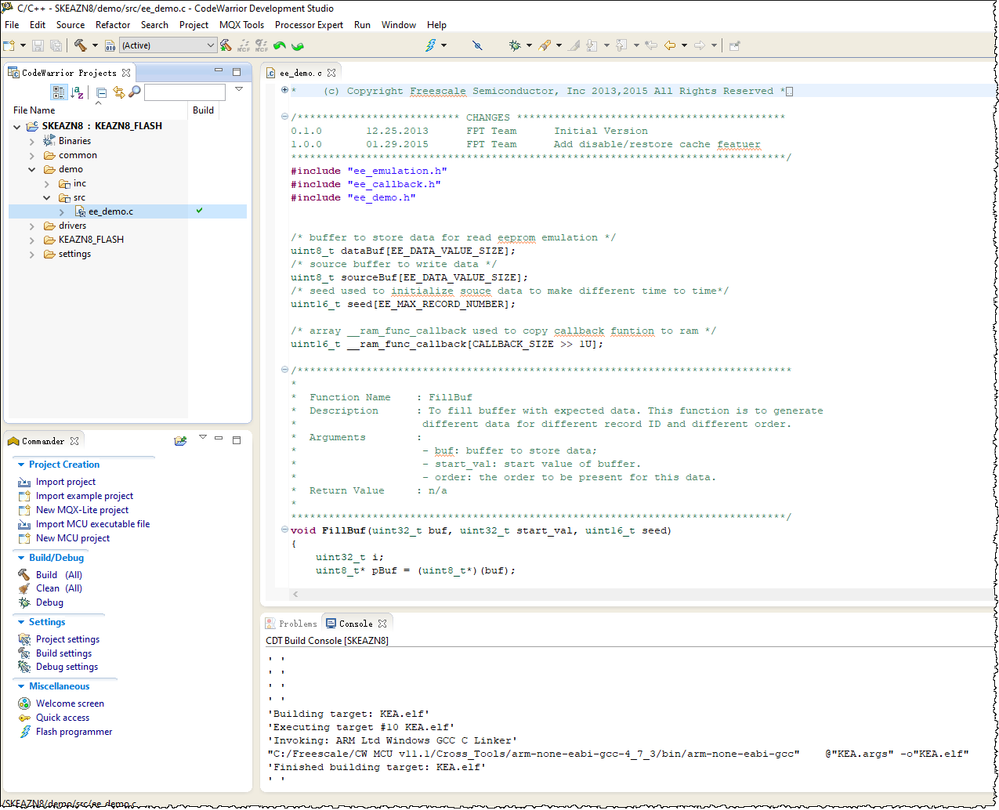

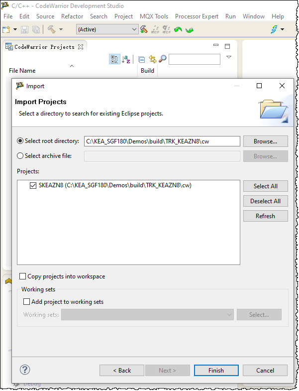

Please try to copy and paste the folder KEA_SGF180 to a place.
And then import the example: KEA_SGF180\Demos\build\TRK_KEAZN8\cw
I am able to build it by using CodeWarrior11.1.
Robin

lim
Thank you for replying Robin
I just try build a project like your last message
but when import a project, problem has occurred like first picture
do you have any idea about that problem?
Code warrior ver. 11.1
Thank you

Robin_Shen
Hi lim,
Robin
8,021 Views
lim
Thank you i solved that problem
Thank you very much
