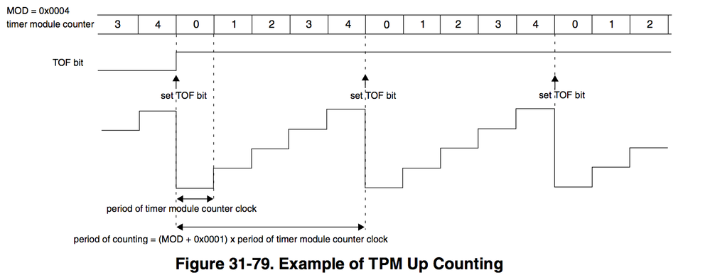

I'm looking to use TPM0 timer with FRDM-KL25Z in order to create simple delay method but there is something I don't understand.
TPM0 work well after initialization but its period isn't like what I expected. If I test a n second delay, the delay loop will be 2n seconds. Double of time !
Here is a quick configuration for 1ms delay :
  • I loaded 1000 to MOD register.
  • MCGIRCLK is routed to TPM modul and run @4MHz (fast IRC).
  • Prescale /4.  -> input module counter  = 1MHz
If I read KL25Z reference manual. The period of TMP0 in up counting mode is =  (MOD+1)* Period of timer module counter clock = 1001*(1/1MHz) = 1ms. (Am I right ?)
What going on with TPM0 ?!

Hi Max,
Thanks for the information! Actually there is no divider by 2 on MCGIRCLK,  but there is a divider named as FCRDIV following the 4MHz IRC and right before it becomes MCGIRCLK, and the default value for FCRDIV is 1 meaning that Divide Factor is 2. so I am suspecting if you didn't change the value in MCG_SC[FCRDIV] in your application code so that MCGIRCLK is 2MHz for your case, and therefore you would meet such issue. Would you please help to confirm that? Please kindly refer to the following for details.
Hope that helps,
B.R
Kan

Kan_Li
Hi Maxtime,
How did you measure the period? did you get it from the blue LED? Per your code, this LED was  toggled in the TOF event of TPM, so the period of waveform on blue LED would be double time of TPM period, for example, this LED was turned on for 1ms, and then turned off for the next 1ms, and so on. so that you will observe a 2ms period waveform on the blue LED.
Hope that makes sense,
B.R
Kan

mr_max
Hello Kan,
I mesure the period with the help of an oscilloscope. Blue LED is set during 2ms and clear 2ms too. So there is a 4ms of period.
Like Mark said above, a divider by 2 on MCGIRCLK could be the reason of this unexpected double times period.

mr_max
Write ! I didn't notice it .
Thank you Kan. It's work very well now :smileyhappy: , I can go further now with UART, I2C and then I2S (on FRDM-KL26Z and Sparkfun Codec Shield). Can't wait to start it ! :smileygrin:
