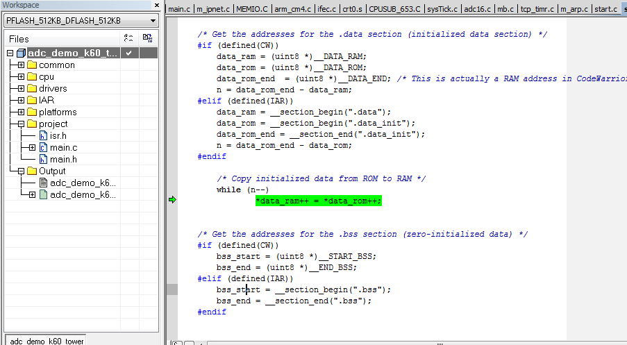

1. When I changed 0x1fff0410--0x1fffffff  to 0x1ffe0410--0x1fffffff ,  no errors after compile but the system would be trapped at a while loop in startup code showed after.
    The variable 'n' in that loop stopped at 719 and never decrease.
2. When I changed 0x1fff0410--0x1fffffff to 0x1ffe0410--0x20001000 (not 0x20010000), no errors after compile and the system runs well.
3. As showed in the pic up, the code executes in flash.

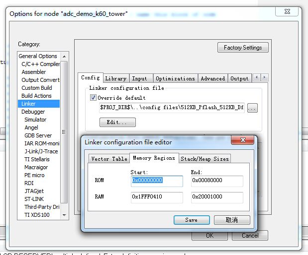

wangfukai
Hi Erland,
     I changed RAM region 0x1fff0410--0x1fffffff to 0x1ffe0410--0x20001000. There are two ways to do this.
     1. Edit the icf file. There are many icf files in the directory build->IAR->config files. In my project I used "512KB_Pflash_512KB_Dflash.icf"
     That's how I changed it.
  2. Change it with the IAR IDE
