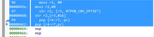

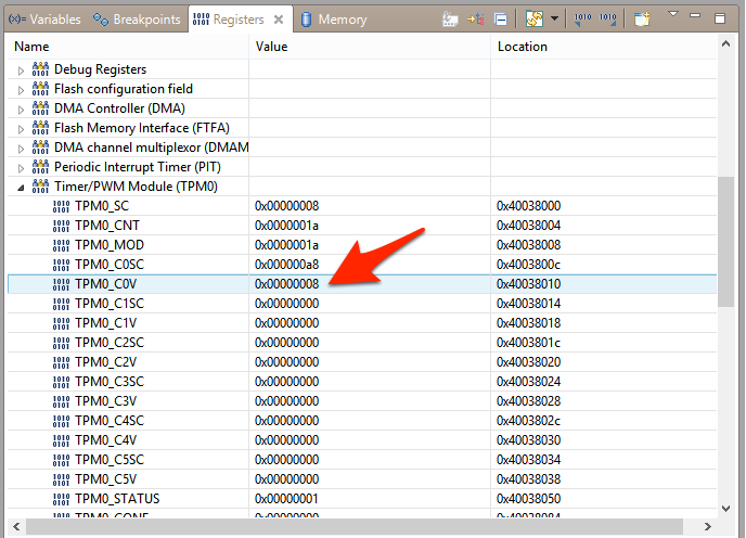

After investigating problem (2) described above (a write of a 0 to TPM0_C0V not taking effect), I managed to capture the event in a debug session. I am trying to attach screenshots, hopefully this will work.
Note that the breakpoint is set right after the write executes. So we are looking at the state right after I wrote r2 (0) to the location at r3+0x10, which is 0x40038000 + 0x10, or 0x40038010. That's TPM0_C0V, and all the previous writes (I write to it every microsecond or so) have happily succeeded. But this one does not, and TPM0_C0V remains set to 8 (its previous value).
Note that TPM0_CNT at this moment equals TPM0_MOD, we are about to overflow. Could this have something to do with the write failing?
If I insert additional instructions in the code above the breakpoint, the problem disappears. The write succeeds and no pulses are generated after the write.
TPM0 runs at bus speed, 20MHz in this case (you can see the divider is set to 1). So does the core.
This setup reproduces the problem reliably, every time. Without the debugger attached the result is endless pulses (length 8) from the TPM0 channel 0 output pin. Well, endless at least for another 50-200µs, which is the length of the busy-waiting delay loop that sits right after the return from the function displayed in the screenshot.

There shouldn't be anything that causes a write to a channel value to fail.  The fact that the counter is about to overflow may cause the timer to not update immediately (which is currently already described in the reference manual in section 31.4.8).
Yes, I'd expect that, and that is fine. One more timer period with the old C0V value is something I expect. What I do not expect is that the write never makes it to C0V. I am out of ideas -- the only remaining idea I have is that if one writes to C0V two times during a single timer period, only the first write makes it?

So I finally had a chance to jump into this one.  I believe understand what's going on.  The problem is that when you try to write 0 to the channel value register (C0V), you have already written to C0V once during that period.  In this case, the second write is ignored (most of our peripherals would take the second one but the TPM is different). This is why we always suggest using interrupts or DMA.  Both of these mechanisms would use the module flags to update the channel value register and therefore, your values would always be in sync.  You would only get one write to the channel value register per period.
This is already documented in the KL26 reference manual (which has the same TPM module) but the updated information has not made it into the KL05 reference manual yet.

Thanks, this explains the issue I was seeing. It definitely deserves a mention in the documentation.
