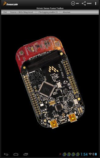

If you have an Android device and go to Android Play, you can download Freescale's Xtrinsic Sensor fusion toolbox.
In the documentation the FRDM KL25Z and other KL series are mentioned using a FRDM-FXS-MULTI freedom sensor shield.
I can't find any data on this shield, has it been released yet? does anyone else know about it?
Yours Simon M.

Also included in Freescale Xtrinsic Sensor Fusion App is built-in support for Avnet's "Wi-Go" sensor board for which applicable FRDM-KL25Z application software (for full tilt-compensated eCompass function as well as Wi-Fi communication with the Freescale App) is available to developers.
More detail on the Avnet Wi-Go board (and reference software) is available here:
http://em.avnet.com/wi-go
Peter Fenn
