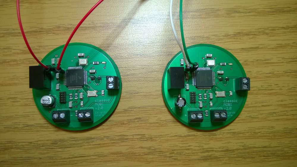

I have a very strange situation happening. I am trying to build a simple PCB with an onboard I2S Microphone using the MK22FN512VLH12. I use DMA.
I have built two PCBs that are identical. The components on the PCBs are working and can do printf, switch LED, etc... However, only one of them can obtain data from the I2S microphone!!! You would say the microphone isn't working in the PCB that doesn't work, but I know for a fact the microphone is not the issue. This is confirmed by an oscilloscope and another successful program that doesn't use DMA and can read data from the microphone and output it. I have done some tests and it seems that in the PCB that is not working the program only enters the DMA0_IRQHandler exactly 1 time, in the PCB that works it access it every time new data is available.My program essentially sets up I2S, sets up DMA, and then uses the ARM DSP library to do some FFTs, nothing more. The I2S set-up seems to be working since I use that in the successful non-DMA program in the faulty unit. Here is a pic to prove it, the red PCB works, the Green and White doesn't:
How can this be possible? Identical hardware, identical software, yet not the same behavior. Is it possible that when soldering something heated up too much and failed? Hard to believe since the faulty PCB seems to be able to do about everything but obtain data from the microphone. Here is all of my code:

Got it! If it's not the hardware, and it's not the software, it must be some sort of initial state. The DMA_TCD0_CSR register has different initial values on each PCB, making only one of them work. The solution was initializing the register to 0. Now the question is, is this normal behavior?

Hi,Eduardo,
Regarding your code,  DMA_TCD0_CSR |= 0x41; because you use I2S0 to trigger DMA, I do not think it is necessary to set the START bit in CSR register.
Regarding the issue, I suggest you check the DMA_ES register, it lists the error flag, it the DMA works fine, it should be zero.
Hope it can give you clue

Thank you XiangJun. It seems that in both PCBs the SGE and SBE error flags are thrown. But why does one PCB work and the other doesn't? And what could be the error?
Edit: Could it be that each micro controller has different initial value bits on reset? The hardware is not the problem and neither is the software... This is really strange.
