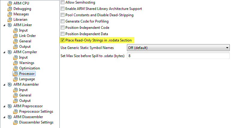

There is a setting you might try:
But in my little test that constant array was in FLASH for me.
I have attached my project (just in case).
So it works for me out of the box, and I'm wondering what might be different in your setup?
