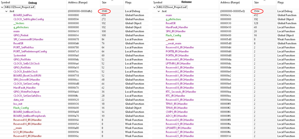

I have a MKL03Z8VFG4  project that I am just starting.
To check that MCUXpresso was installed correctly, I used the web site to create an SDK for it, configured the LED pins and was able to blink the LEDs.
For my "bare metal" design, I created an SDK for MKL03Z32xxx4 using the web site. I got the ports configured using the Config Tool, Open Pins. So far, so good.
Here is the result after the build. This is with the example printf("Hello World\n"); commented out, with that in it would not fit at all:
Memory region  Used Size | Region Size | % Used
PROGRAM_FLASH:   5720 B  |    8 KB     | 69.82%
         SRAM:    596 B  |    2 KB     | 29.10%
That is pretty sad for not a single line of user code.
So my question is:
Is there a slim / minimal startup code example for the MKL03Z8VFG4 somewhere?
Thanks in advance for any assistance you can offer.

baxsie
So it looks like:
  • Project Explorer tab
  • (right click on project) -> Properties
  • C/C++ Build -> Settings
  • MCU Linker -> Managed Linker Script
  • Library- -> Pull Down "Redlib (none)"
Gets rid of the file system, and heap. With a null while loop in main(), that gets me to :
PROGRAM_FLASH:   1800 B  |    8 KB     | 21.97%
         SRAM:    400 B  |    2 KB     | 19.53%
Significantly better, if still pretty fat.
Adding in:
 BOARD_InitBootPins();
 BOARD_InitBootClocks();
 BOARD_InitBootPeripherals();
Bloats it right back up:
PROGRAM_FLASH:   3480 B  |    8 KB     | 42.48%
         SRAM:    404 B  |    2 KB     | 19.73%
(Sorry for the stream-of-consciousness post . . . I'm moderated.)
2,747 Views
baxsie
By switching to Release, setting -Os (size optimization), -flto (Link-time optimization), RedLib(none) that can get it down to:
PROGRAM_FLASH:   1504 B  |    8 KB     | 18.36%
         SRAM:    264 B  |    2 KB     | 12.89%
The same program, using Debug, -O0 no link-time optimization, RedLib(none):
PROGRAM_FLASH:   3588 B  |    8 KB     | 43.80%
So, while I think 1504 bytes is still pretty huge for startup code, it is much better than the 5700 bytes I initially saw.
Here is a screen shot of the Release and Active code space usage:
