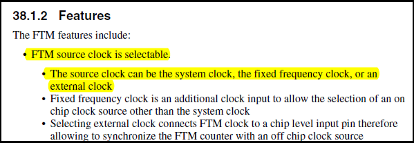

I would appreciate if somebody could help me understanding the clock system.
In the past I allready worked with a FRDM-KL25Z board and I was quite with it and the Code Warrior.
Now, I am developing a new project and I have to choose a new microcontroler as the KL25Z is not as fast as I need.
The point is that I need to create a 120MHz square signal from an GIO pin, and I wonder if I could use a FRDM-KV31 board that can run up to a frequency of 120MHz
This is clock diagram of the KV31:
My intention is to make use of the Flex Timer Module (FTM) to do so, and it says:
So I understand that Core/System clock is 120MHz so I believe that I would be able to create a 120MHz square signal. Am I right?

Hi patricio‌,
No, I think you have some misunderstandings about the documentation and what is possible.
Firstly, chapter 38 (which is where your excerpt is from) is specific to the FTM and those clocks it refers to are local FTM clocks.  To find out which chip level system clock sources the FTM, you need to check chapter 5 (table 5-7 to be more specific). From this table you'll see that the FTM is sourced by the Bus clock (which is 60MHz or less).
Secondly, you have to also remember that if the FTM is sourced by a 60 MHz clock, you won't be able to create a 60 MHz waveform.  The most you would be able to make is 30 MHz and that is pushing the limits of the module.
Thirdly, you have to also remember that there is a limit to how fast the pins can transition.   This may also limit the frequency of an input or output waveform.

Hi Aitor
I believe that the maximum FTM output will be half the system clock due to the fact that it can toggle the output on each match. This means that if there is a match each system clock it will generate a square wave at half the system clock rate.
