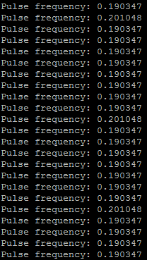

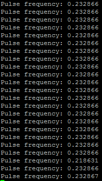

es483
Thank you very much for your reply!

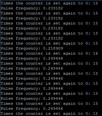

I tried your code today with different frequencies (10 Hz/5 Hz/2 Hz/1 Hz), but unluckily it is still giving the wrong result, it seems due to an incorrect computation of the number of times the counter is set to zero (and so the TOF bit is consequently set).
Doing some debug and adding a few serial Printfs, it seems that the overflow counter for 1 Hz goes up to 7 (it is too much for a 1 Hz waveform?), but not always (sometimes it seems to stop at 6)...
The attached one is for example the output I get for a 2 Hz waveform: I should have obtained a quite stable "2.[something]" (or, I suppose, 1.9[something]) instead of an unstable value of 0.19/0.20...
Is there a way to know how many times the FlexTime overflowed instead of reading each time the TOF and incrementing a global variable?
Is there some numerical problem in the code that leads to problematic results such as the ones I'm obtaining?
The strange thing is that even for higher frequencies, where the overflow counter should remain equal to 0 (or at least 1, that is taken into account in the if-else part of the FTM0 handler), I get an incorrect (but seems to be more stable) result, even when calling the FTM timer to do a conversion each 2 s.
Thanks a lot in advance!
Output for 2 Hz:
Output for 10 Hz:

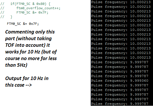

Output for 10 Hz without considering the FT0_overflow_count:
Update: doing a few other test, it seems that the overflow counter is getting everytime a value which is too high (or the board is missing the CH03 event, so, never resetting the FTM0_overflow_count variable): for 10 Hz it should be (I think) 0 or 1, but I'm actually getting 15 or 16!
