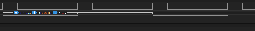

The required output.
I am not able to get output on both channels simulataneosuly.

aniketmarkande
When i am running only one channel(FTM3_CH7) it is working properly. Same settings i did for second channel(FTM3_CH6), then also its not working.
