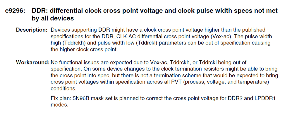

Before to answer your question, I am not sure if you had aware of the errata for K61. See below:
https___community.nxp.com_servlet_JiveServlet_downloadImage_2-1101156-250312_pastedImage_1.png
So we do not have a recommend on "need" or "need not". The only suggestion is to try adjusting the series resistor values to delay the clock on your board to meet the spec.

Well, I am thinking that you may misunderstood the "clock crosspoint". If clock crosspoint is not located at 50% of signal amplitude, that sometime takes place since rising and failing slopes differ. Such effect may influence on operations of JEDEC.
Yes, I misunderstood about the clock crossing point.
Based on your explanation and also on the errata e9296, I now understand as follows;
(Here, I focus on LPDDR to simplify the discussion.)
1) The crossing point voltage of the clock signal outputted from these pins can be adjusted
    by implementing a resistor between DDR_CK pin and DDR_CKB pin.
2) The resistor implemented between DDR_CK pin and DDR_CKB pin is
     NOT directly related to High pulse width and Low pulse width of the clock.
 3) On the Rev.7 datasheet of K61P256M150SF3, Table 26 says that Vox-ac for LPDDR is
     Min 0.4*VDD_DDR/ Max 0.4*VDD_DDR.
     But this includes typo and correct values are;
     Min 0.4*VDD_DDR/ Max 0.6*VDD_DDR.
4) The above-mentioned description regarding Vox-ac means that
    K61 controls the clock outputted from DDR_CK pin and DDR_CKB pin so that
    its crossing point voltage is within the range between 0.4*VDD_DDR and 0.6*VDD_DDR for LPDDR.
5) Roughly speaking, e9296 says the following two points;
      a)There is a possibility that crossing point voltage of the clock outputted from DDR_CK pin and DDR_CKB pin
        is out of the range between 0.4*VDD_DDR and 0.6*VDD_DDR for LPDDR,
        which violates the specifications on Vox-ac shown on the K61 datasheet.
        For example, it is possible that the crossing point voltage may become 0.65*VDD_DDR for LPDDR.
        (But this will be fixed at 5N96B mask set.)
      b)One possible countermeasure to the problem mentioned on above a)
         may be adjusting the crossing point voltage by adding a termination resistor,
         which means the resistor implemented between DDR_CK pin and DDR_CKB pin.
Are above 1)-5) correct?
I'm sorry to  bother you repeatedly, but if the above 1)-5) include any mistakes,
please let me know them.
Shinsuke Tanaka
4,668 Views
miduo
Hello, Shinsuke Tanaka
Yes, all the above 5 points you mentioned are correct. Actually from our experience & observation, under most circumstance, even the clock crossing point out of spec, we do not see malfunction. Anyway, this had been fixed in new revision.
