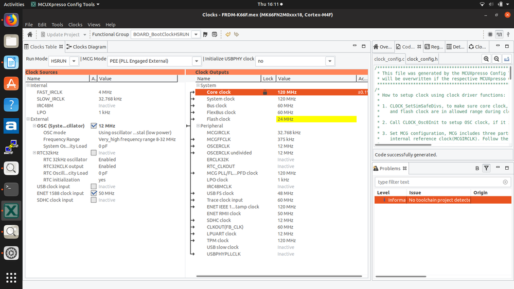

When porting GT202 Wifi Driver to FRDM K66f board Initialization is getting failed. The driver Could not read the referenced clock correctly. I am using HS Run Mode with peripheral BUS clock as 60MHz.

           Thank You.. I am able to build the frdmk66f qca_demo project similar to FRDMk64F, First Step of the application validates SPI communication, which it passed..(i.e I could read one of the registers in the Wifi Module.(it matchs with cofigured MACRO). The application reads reference clock of the Wifi Module, this is where it hit ASSERT and fails. The Driver Developer has commented saying that hits assert statement some times and it needs to investigated. I doubt whether the wifi driver is validated across different kinetics platforms( i.e K22F, K66F, etc..). I attached the Clock configuration image. Please let me know best steps to debug the issue.ClockConfig.png

Hi Srinivas,
    You also need to check the K66 according pins to your GT202, you need to make sure the according pins in the FRDM-K66 can work with your GT202, because the official side don't have the direct K66 wifi code for your reference, then you need pay more effort on the code compare with the K64.
Anyway, if you need any help from my side, just let me know.
Actually, the GT202 is EOL now, I don't know why you still use that module, you can consider silex wifi module:
Connectivity Solutions > Embedded Wireless > SX-ULPAN-SHIELD
I even don't have the GT202 on my side, and I also can't get that board, because it is EOL now.
Wish it helps you!
Kerry

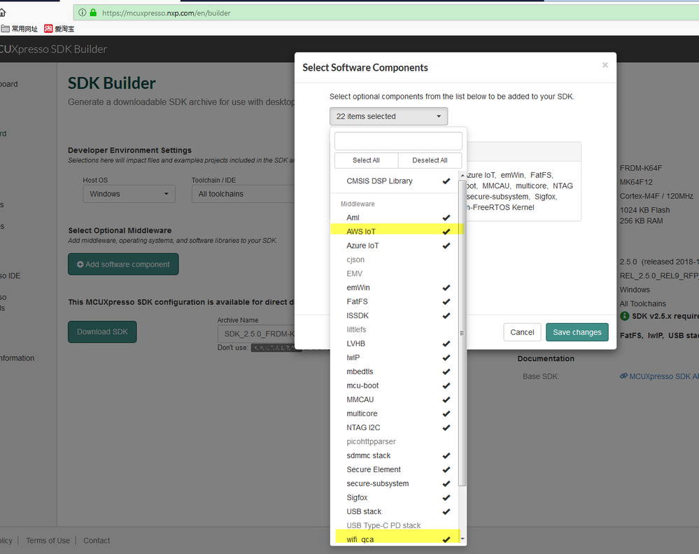

kerryzhou
Hi Srinivas Ardha,
     Do you try the Run mode, then configure the BUS clock to 60Mhz? Then you can refer to the FRDM-K64 wifi driver code and project.
    The FRDM-K64 SDK have the according examples, you can download it from this link:
https://mcuxpresso.nxp.com/en/select
  But please note, select the wifi qca item:
  You can find the wifi qca code from this folder: SDK_2.5.0_FRDM-K64F\boards\frdmk64f\wifi_qca_examples
