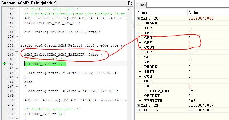

After debugging I found the following scenarios.
I disabled the Comparator Module, before updating the DAC value, and here CFF bit is set (my understanding is, since we disabled the module, Comparator Output changes from High -> Low, hence this happens)
After updating the DAC value for falling edge, I enabled the Comparator, and due to the my setup position, COUT is now 1 again, and hence CFR bit is also set.
And this messed up by simple state-machine.
But if I run my code by commenting the line ACMP_Enable(DEMO_ACMP_BASEADDR, false);, everything works fine, for obvious reason.
Can you please suggest, should I proceed without disabling the module?
The reason I disabled the module is because I am changing the DAC values and enabling only one type of interrupt at a time.

Hi @arun07 ,
Yes, when you enable the  comparator, it will perform a comparing. So, even you clear CFR and CFF in Custom_ACMP_ReInit, CFR or CFF will set after comparator enable. I delete the disable comparator command, then it works fine.
Jing

arun07
Thanks @jingpan
So if we don't disabled the comparator module, it works fine.
