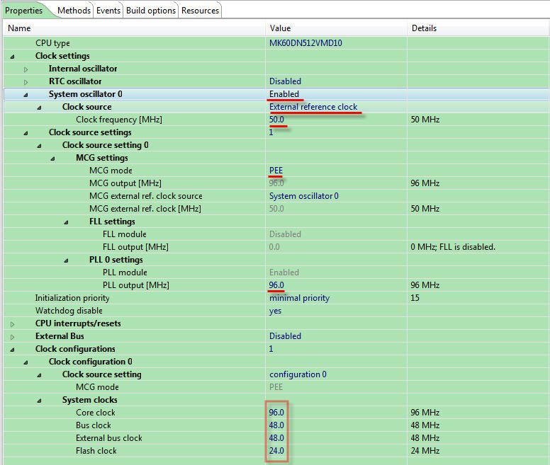

I think the time is set to the following results:
The kernel/system clock          96MHz
The bus  clock                        48MHz
The Flex Bus clock                 48MHz
Flash clock                            24MHz
How to set up?
Best can have pictures of codewarrior operation
I am using is TWR - K60D100M development board
1,602 Views
Robin_Shen
I think you can refer it:
Hope that help
