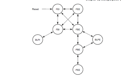

Additionally I have a question, you're saying that the defaut mode is FBI, isnt the default mode FEI ?
The documentation says that to reach PEE mode from reset, I have to go through FEI (reset mode) -> FBE -> PBE -> PEE.

I am sorry, this is typo, after Reset, the default mode is FEI instead of FBI.
Pls refer to the clock configuration attached in similar register writing.
