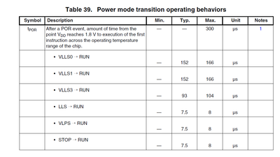

Hello @aberger
1) What about the part number you use? You can find power mode transition time for your chip from data sheet, for example K32L2B3x:
2)"What is the impact on recovery time? "
PSTOP1 is functionally similar to Stop mode, but offers faster wake-up at the expense of
higher power consumption. Another benefit is that it keeps all of the MCG clocks
enabled, which can be useful for some of the asynchronous peripherals that can remain
functional in Stop modes.

Yes, I'm aware of the table that you referred to, but that just shows recovery time from STOP to RUN, and does not provide details about the Partial Stop options. You mentioned that PSTOP1 offers faster wake-up time than STOP. How does it compare with the 7.5 µs?
2,689 Views
Hello @aberger
There is no wake-up time from PSTOP1 to RUN in DS, I will confirm with internal.
