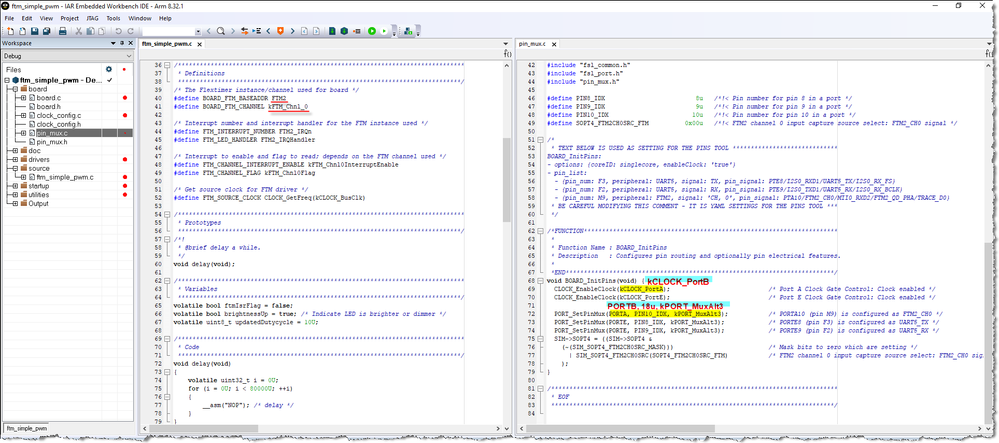

I used the simple exemple in my twr-k60d100m proposed by MCUxpresso sdk to generate a PWM with the FLM but i want to use a GPIO as a Pinout not the defaut FTM pinout, can someone help me to do this.

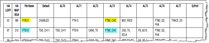

The ftm_simple_pwm example in MCUxpresso KSDK_2.2.0_TWR-K60D100M select PTA10 for FTM2_CH0.(...\KSDK_2.2.0_TWR-K60D100M\boards\twrk60d100m\driver_examples\ftm\simple_pwm)
PTB18 can also be used as FTM2_CH0 function.
Here you can refer:
Robin
