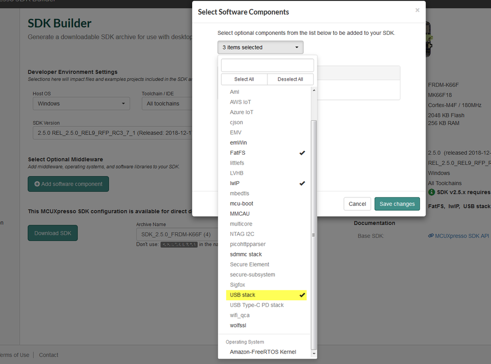

Hi, I need to use the MK66 USB for large high speed data transfers and short commands.  I have the FRDMK66F example, but I can't find which USB example is most applicable to what I need.  Can you recommend an examples?
Thank you!

    MSD is the USB bulk transfer, and HID is the Interrupt Endpoint transfer, so you can refer to the FRDM-K66 msd and HID code.
   You can refer to the official SDK code for FRDM-K66, which can be downloaded from this link:
   Welcome | MCUXpresso SDK Builder
  Choose the FRDM-K66, then in the middleware, select the usb stack.
   Then you can build the project, download the SDK code,and you can find the usb code in folder:
SDK_2.5.0_FRDM-K66F\boards\frdmk66f\usb_examples
Wish it helps you!
