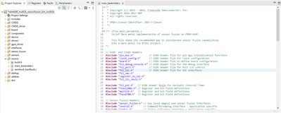

I am using FRDM-K64F and FRDM-FXS-MULTI2-B to do sensor fusion.
I am using MCUXpresso 11.5.0 and SDK 2.10.0.
I can see all library and project "main_baremetal" are there...
When I try to use "import SDK sample project", I can't find it?
Can anybody tell me how to import this project in MCUXpresso and I can test it with Fusion tool box?

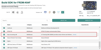

Hi @a8Chcx,
Could you help me check the SDK builder here: Select Board | MCUXpresso SDK Builder (nxp.com), and search for the board you are using (K64F), then click on build SDK.
In the next menu, you can select all the middleware available, or just make sure you have the sensing IoT checked:
After this, install it in MCUXpresso and you should have the project examples available under "frdmk64f mult2b" and under "sensors".
Hope you find this helpful!

Hi Julian,
Yes. I put SDK 2.10.0 into MCUXPresso and I can see the project under ...\SDK_2_10_0_FRDM-K64F\boards\frdmk64f_mult2b\issdk_examples\algorithms\sensorfusion\baremetal_mult2b
But, when I use "import SDK Example(s)", I can't see this project?
Can you tell me how to import it because I want to copy all related files and this project becomes independent?
Christie

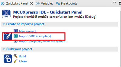

Hi @a8Chcx
If you have installed the SDK into MCUXpresso already, you should follow these steps below:
Click "Import SDK example(s)..."
Select the kit "frdmk64f_mult2b"
Under "issdk" and "algorithms" is the project "sensorfusion_bm_mult2b"
After these steps, you should have the project imported and ready to use.
If, by any chance, you still can't seem to import it, please update the SDK to version 2.11 and try again.
Best regards, Julián

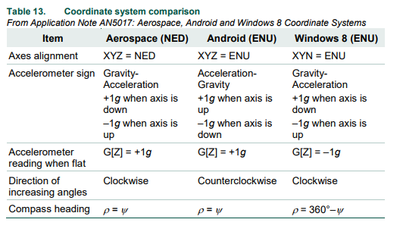

Another question:
Based on NED definition:
ACC is +1g when axis is down, -1g when axis is UP.
GYRO: Increase when in clockwise.
MAG: What is definition for MAG? I can't find in document...
Why need to apply the following for NED?

Based on ACC definition for NED:
Do you think that X_acc=(-1)*Y_acc, Y_acc=(-1)*X_acc, and Z_acc=(-1)*Z_acc?
For MAG, it matches the definition because when X up, X-mag is MAX and X down, X_mag is MAX...
Christie

I read this many times and still not sure:
Based on NED, when axis point down, ACC reading should be positive, right? NXP fusion definition is opposite to NED definition?
But for MAG, when axis point down, MAG reading should be MAX, right?
There is no MAG definition in document...Can you tell me where I can find it?
Christie

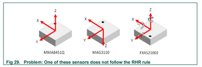

Hi @a8Chcx,
Yes, when axis is pointing down, acc should be positive. Only the MAG3110 sensor is inverted in it's z axis, that is why in the drivers, sample CHZ is negative, to compensate this behaviour.
Yes, you are correct: When pointing the axis down, the reading should be maximum.
Best regards, Julian

Hi Julian,
I think MAG is *(-1) for FX8700 MAG, not for MAG3110.
For MAG3110, it should keep as it is because Z axis is opposite already.
I am confused with ACC because ACC points down, it always read -1g, not 1g.
EX. when flat, ACC on Z is 1g. Why not to do (-1) conversion that it is the same as MAG?

Hi @a8Chcx,
A sensor flat should read +1g, as it is only reading Earth's gravity, and the other two axes should read 0;
You can also refer to this note (Implementing a Tilt-Compensated eCompass using Accelerometer and Magnetometer Sensors (nxp.com)), at chapter 2, where it is showing the final revisions while implementing an accelerometer and magnetometer in a PCB:
"The z-axis accelerometer should read +1g and the x and y axes
negligible values. Invert the PCB so that the z-axis points upwards and verify that the z-axis
accelerometer now indicates -1g."
If your application needs the contrary behaviour, you can implement that yourself in code, by just negating the axis.

a8Chcx
Contributor V
HI Julian,
That is what confused to me.
When flat, Z is pointing UP and reading is 1g. The same for X and Y because I tested the raw data reading.
But, in fusion project, it didn't do *(-1), why?
Based on NED definition, pointing DOWN, it should positive, right?
Christie
9,273件の閲覧回数
Julián_AragónM
Hi @a8Chcx,
When flat, the z-axis is pointing downwards, which is why the board or the value is +1g. When inverting the board, or any other PCB, the z-axis will point upwards, which will indicate a -1g.
