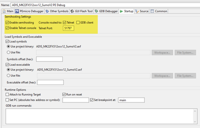

Hi everyone.
I´m working on MCUXpresso IDE v11.5.0 and I´m using MKE02Z64VLD4 microcontroller and PEmicro Multilink Universal PEM5738A6 debugger.
When I build my project, I don´t have errors or warnings but when I try to debug it, this message appears:
Could not connect to semihosting port due to connection timeout. Please check that the correct port number is configured.
Could someone help me?
Thank you so much.

Hi @ernesto14 ,
Make sure you have configured Semihosting in the debugger launch configuration as below:
The other hint is: make sure you have selected a library with semihosting, e.g.
I hope this helps,
Erich
