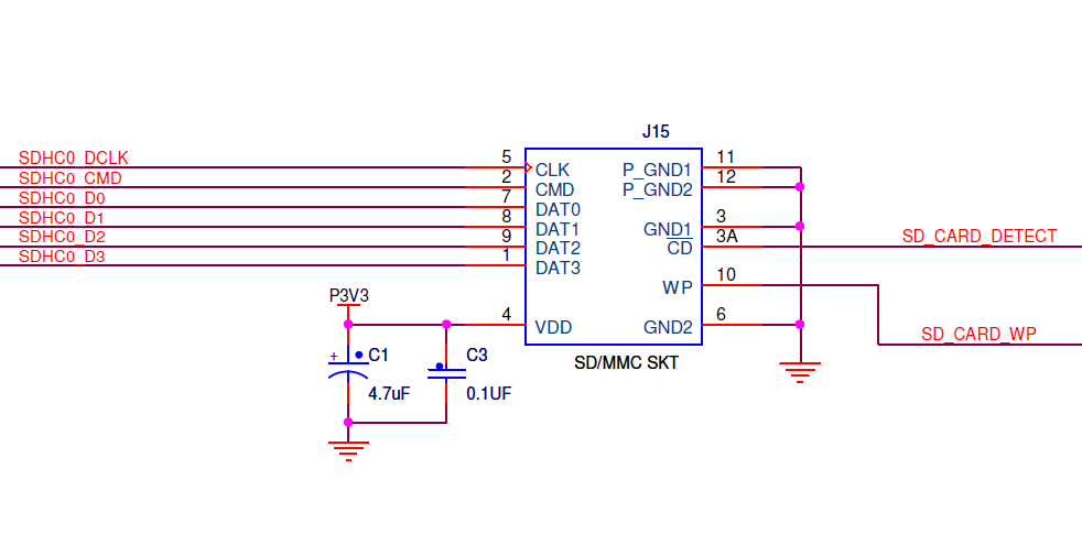

I have a problem with a custom card and the MK60FX512VLQ15.
I have a SDCARD connector. It is mapped on the pin 1, 2, 3, 4, 7 and 8 (SD1, SD0, SDCLK, SDCMD, SD3 and SD2).
The Card Detect signal is mapped to PTA4 (pin 54).
When I put a SDCARD inside, everything is ok.
The problem is when I let the SDCARD inserted.
In this case the program don't boot and if I try to program it with the JTAG mapped from PTA0 to PTA3, the K60 cannot be reach.
What am I doing wrong?

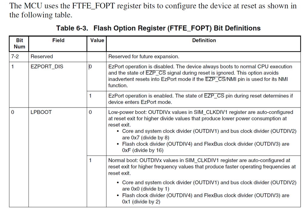

EZPORT can be disabled from the NV_FOPT flash space. The next thread provides some hints about this:

I can't post the schematic right now.
The SD Card slot is well connected. I checked it before. And it works well. Hte problem is only at the startup.
After some investigation, it seems to have some conflicts with the EZP_CS signal. My SD_CARD_DETECT signal is on the EZP_CS pin.
When the card is inserted in the slot, the SD_CARD_DETECT signal is pull_down. So I think that the EzPort operation is enabled.
So I think that I need to disable the EzPort and after set this pin as an IO.
But if I don't change this option in the boot sequence, it won't works.
I tried to write the FOPT register but without any succes. I didn't find the right way to do this.

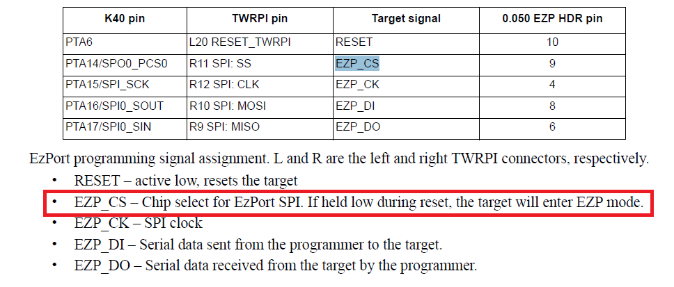

Update: if EZP_CS rises with VDD the board will not enter EZPort.
5,560 Views
guillaumetiffin
Exactly but when a SD card is inserted, the signal is pull down. So I need to disable this functionnality.

If you want to do it the software way, put this in your code:
FTFE_FOPT &= ~(0x02);  // EZPORT_DIS cleared , EZPort Operation disabled.
// This is just to make sure it disables the EZport mode pins
PORTA_PCR6 |= PORT_PCR_MUX(1)  // Set PortA pin 6 as PTA6 function
PORTA_PCR4 |= PORT_PCR_MUX(0)  // Set PortA pin 4 as IO (EZP_CS_b)

I got the same problem, here is my solution:
You must set NV_OPT, because FTFL_OPT is loaded with the value NV_FOPT at each reset.
But you cannot just dynamically set NV_FOPT = 0xFD, because NV_FOPT resides in the program flash sector.
So you have to find the the sector cfmconfig in your code,change it, and recompile .
Note that if you use mqx(4.1.1), PEx will not do the expected job because the bsp values take the place in this sector.
After checking that the register FTFL_OPT is now correct, if you still have problems, look a the NMI ...

The problem is , if the EZP_CS pin is low on reset, the k60 will enter EZP mode as stated here:
I would try to set the Reset Signal pin to High and see if i can set the pin as an I/O, i don't have my board right now but i will try as soon as possible if this can be done.
The EzProg can operate as a MicroSD card reader, i recommend you to read this AN: AN4406
I'm looking for a workaround right now.

Make sure your SD connector is connected to grounds like this:
Would be useful if you can post your SD custom board to take a look at it. I'll keep looking for the problem.
