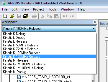

Colleague Santiago is right, you are trying to build for an incorrect target. Please confirm two things:
1) There are several build configurations. Make sure that you build the one corresponding to your device:

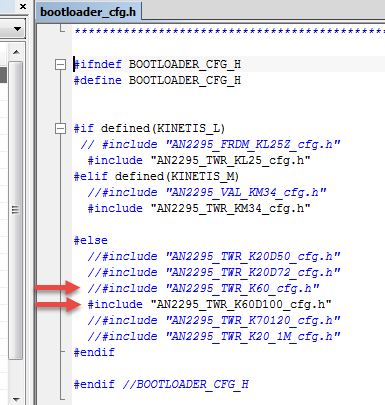

2) You do not mention the specific tower board you have. Is it TWR-K60D100M or TWR-K60N512? According to this, you have to modify the file called "bootloader_cfg.h". Comment all of the includes except for the one of your board:

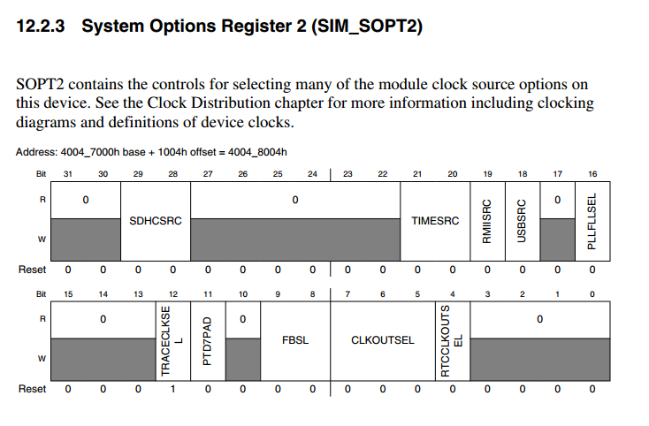

Your problem is that you are using code of Kinetis L devices in a Kinetis K. Registers are different in both devices.
All the errors you are getting are because there is no such field in the registers, and they are not defined in K60D10.h. For example, if you take a look at the first error:
Warning[Pe223]: function "SIM_SOPT2_TPMSRC" declared implicitly C:\Users\Xavier\Desktop\Developpement\kinetis\Bootloader\AN2295_Kinetis_rev5_works\CommonSource\Bootloader\bootloader.c 357
and then you check the register SIM_SOPT2 in the Kinetis K60 100 MHz Reference Manual, you can see that there is no field "TPMSRC":
